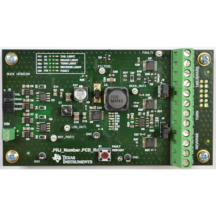

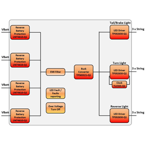

TIDA-00677 TI reference design demonstrates a solution for automotive LED taillight applications (tail/brake lights, turn signals, reverse lights) using the TPS92630-Q1 linear LED driver powered by an upstream buck converter (TPS65321-Q1) scheme, the converter is powered directly by the car battery voltage through the smart battery reverse diode. The design has also been EMI/EMC radiation and pulse tested according to CISPR25 and ISO 7637-2. More information on potential cost savings and high efficiencies (power dissipation, system thermal performance) can be found in the user guide. See TIDA-00678 for a similar design driven by a boost converter. For a similar design powered directly from the car battery, see TIDA-00679, a reference design that is powered directly by the car battery voltage through a smart battery reverse diode. The design has also been EMI/EMC radiation and pulse tested according to CISPR25 and ISO 7637-2. More information on potential cost savings and high efficiencies (power dissipation, system thermal performance) can be found in the user guide. See TIDA-00678 for a similar design driven by a boost converter. See TIDA-00679 for a similar design powered directly from a car battery.
characteristic
  • ● Design optimized for efficiency
  • ● Passed CISPR-25 test and complied with EMI/EMC standards
  • ● Outside the AM band
  • ●Can withstand load dump
  • ● Intelligent battery reverse protection

Blockdiagram
