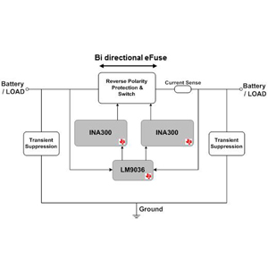

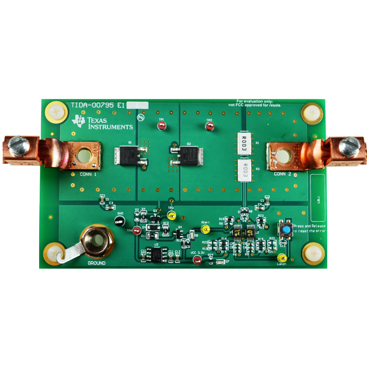

Fuses are used in many products to protect against possible damage caused by current surges and overcurrents. Traditional fuses used in the automotive space have lower accuracy and longer response times. The TIDA-00795 Automotive Precision Electronic Fuse Reference Design is an alternative to traditional fuses that is more accurate and offers capabilities not found in traditional fuses. This electronic fuse reference design can be used as a building block for implementing a multi-channel electronic fuse box. It can also be used in body control modules (BCM) and electronic control units (ECU).
characteristic
  • ● Accuracy: > 97%
  • ● Configurable delay time, able to adapt to surge currents of 10us, 50us and 100us
  • ● Configurable current limit up to 30A (scalable > 100A)
  • ●Response time: up to 10us (can be configured through delay time)
  • ● Meets 12V electrical transient requirements of ISO 7637_2
Backlog Impt notice changes Backlog Impt notice changes end
参考设计图片
Blockdiagram
