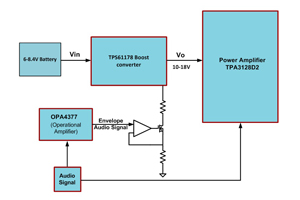

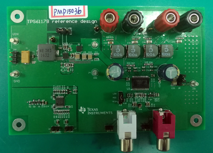

This envelope tracking power supply reference design helps extend battery life in portable audio applications such as Bluetooth® or Wi-Fi speakers. The low-power buck converter in this design features envelope tracking for audio power amplifiers, maintaining high efficiency over the output voltage range. By adding an audio envelope signal to the FB pin of TI's TPS61178 device, the output voltage can change according to the envelope of the audio signal, thereby dynamically adapting to the power supply of the TPA3128D2 power amplifier and optimizing its power consumption.
characteristic
  • ● Input voltage range 5.4V to 8.4V
  • ● When the input voltage is 7.2V, it provides 2X20W power to an 8Ω load.
  • ● Programmable power limit
  • ● Isolate the input battery from the output side during shutdown
  • ● High efficiency, small solution size
