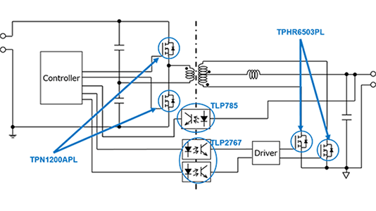

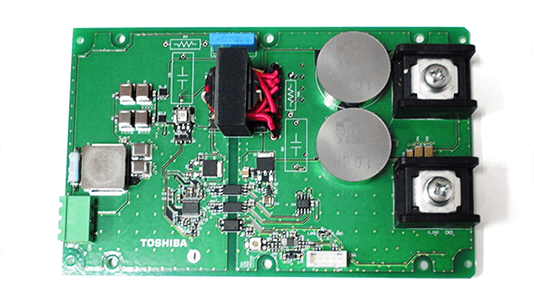

1.2V/100A output DC-DC converter compliant with 48V bus voltage
• Input voltage: DC 40 to 59.5V
• Output voltage: DC 1.2V
• Output power: 120W
• Circuit topology: half-bridge + synchronous rectification
features
• Total efficiency: 92.8% (Vin=54.5V, 30% load)
• Overall dimensions : 160mm×100mm×30mm
• Provides fully suitable power MOSFET and optocoupler.
参考设计图片
Blockdiagram
