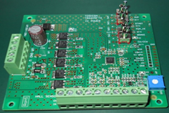

MCD Evaluation Board Design for Pump Motor Control
TB6605FTG Sine wave BLDC motor controller
voltage 10V-28V DC
Motor specifications Medium speed motor 10V-24V/0.5A-10A/output 26W/4000rpm
Motor driver output  + MosFET N-channel + N-channel MosFET (Toshiba TK20P04M)
Main IC TB6605FTG, TC75S51F, TK20P04M
MosFET specifications and packaging information
TK20P04M: NMOS, 40V/20A, DPAK, Rdson=19mΩ
• ØAutomatic lead angle (rotary feedback control)
• Closed-loop control
• Sine wave drive brushless DC motor control
• Transformer switch
advantages
• Prevent speed fluctuations
• No software required, short development time
• Achieve stable water supply control under unstable voltage conditions
• Sine wave driven brushless DC motor control
• Reduced noise
• Built-in motor speed control

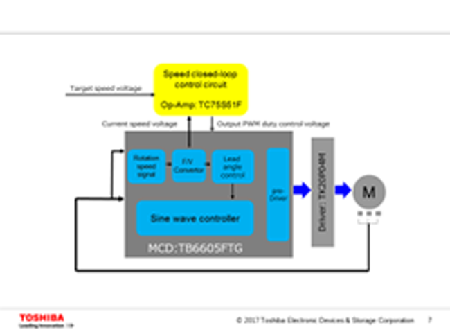

Blockdiagram
