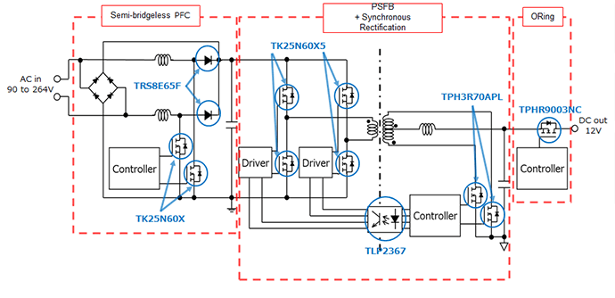

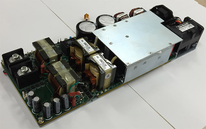

1.6kW, 80+ platinum-level high-efficiency server AC-DC power supply
• Input voltage AC 90 to 264V
• The output voltage DC12V
• Output Power 0.8kW (AC 100V system input), 1.6kW (AC 200V system input)
• Circuit topology Bridgeless PFC, phase-shifted full bridge + synchronous rectification, output O-ring
• Single rack size, high efficiency, high power output power supply
• Total efficiency 93% (Vin=230V @100% load condition)
• Dimensions: 307mm×133mm×43mm (including the base plate under the PWB and the heat sink covered top panel)
• Fully available power devices (MOSFETs and SiC diodes) and optocouplers
参考设计图片
Blockdiagram
