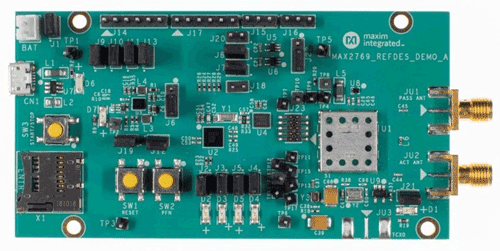

The GPS reference design is an evaluation kit designed to demonstrate the essential features of an ultra-low power GPS (global positioning system) receiver, as well as serving as a reference design to illustrate how to implement such a receiver rapidly. The reference design uses the MAX2769C L1-band GNSS RF front end IC (RFIC) from Maxim Integrated, and the ultra-low power GPS baseband processing firmware provided by Baseband Technologies Inc. (BTI) that runs on a MAX32632 microcontroller unit (MCU).
GPS L1 Snapshot Receiver
Ultra-fast
Position in as fast as 0.9s
Ultra-low power consumption
0.5mW to 1.57mW (at 60s update rate)
Real-time and post-process operating modes
Native arm cortex-M4 design
User selectable signal capture
4ms, 6ms, 8ms, 10ms, 16ms, 22ms, 30ms
Position accuracy: 5m CEP
Passive and active antenna support
SD card support
PC connection through USB
