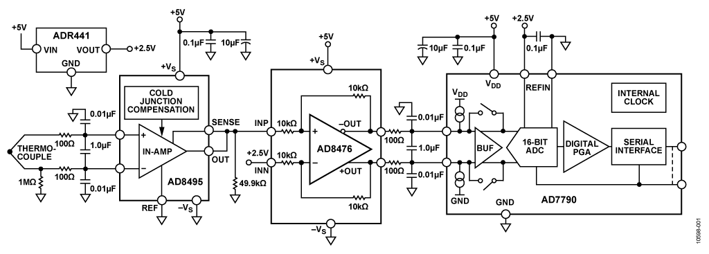

The circuit shown in Figure 1 is a complete thermocouple signal conditioning circuit with cold junction compensation followed by a 16-bit Σ-Δ analog-to-digital converter (ADC). The AD8495 thermocouple amplifier provides a simple, low-cost solution for measuring K-type thermocouple temperature and includes cold junction compensation.
The fixed-gain instrumentation amplifier in the AD8495 amplifies the small voltage of the thermocouple to provide a 5 mV/°C output. The amplifier features high common-mode rejection, rejecting common-mode noise that may be picked up by the long leads of the thermocouple. For additional protection, the amplifier's high-impedance input allows additional filtering to be easily added.
The AD8476 differential amplifier provides the correct signal levels and common-mode voltages to drive the AD7790 16-bit Σ-Δ ADC.
This circuit provides a compact, low-cost solution for thermocouple signal conditioning and high-resolution analog-to-digital conversion.
Figure 1. Type K thermocouple measurement system with integrated cold junction compensation (schematic diagram: all connections not shown)

This circuit uses the AD8495 thermocouple amplifier and operates from a single 5 V supply. The output voltage of the AD8495 is calibrated for 5 mV/°C. When operating from a single 5 V supply, the output is linear between approximately 75 mV and 4.75 V, which corresponds to a temperature range of 15°C to 950°C. The output of the AD8495 drives the non-inverting input of the AD8476 unity-gain differential amplifier, which converts the single-ended input to a differential output for driving the AD7790 16-bit Σ-Δ ADC.
The low-pass differential and common-mode filters before the AD8495 input eliminate RF signals, which if allowed to reach the AD8495, may become rectified and manifest as temperature fluctuations. Two 100Ω resistors and a 1μF capacitor form a differential filter with a cutoff frequency of 800Hz. Two 0.01nF capacitors form a common-mode filter with a cutoff frequency of 160 kHz. A similar filter is used at the output of the AD8476 differential amplifier before the signal is applied to the AD7790 ADC.

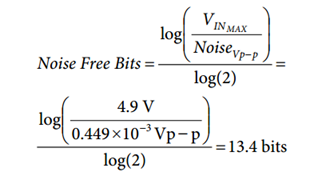

The theoretical resolution of the system can be calculated based on the bandwidth, voltage noise density, and gain of the AD8495. The peak-to-peak (noise-free code) resolution (in bits) is:
CN0271_Image1
CN0271_Image2

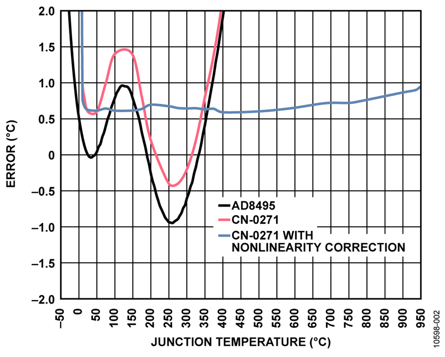

An important measure of the performance of this circuit is the amount of linearity error. The AD8495 output accuracy is within 2°C over the -25°C to +400°C range. To achieve greater accuracy when working within or outside this range, a linear correction algorithm must be implemented in the software. The CN-0271 evaluation software uses NIST thermoelectric voltage lookup tables to ensure output error within 1°C from 15°C to 950°C.
Figure 2 compares the performance of the AD8495 to the CN-0271 system and shows the results after linearizing the ADC output. For details on how to implement this algorithm in software, see the AN-1087 application note Linearizing Thermocouples with the AD8494/AD8495/AD8496/AD8497.
Figure 2. AD8495 output error, CN-0271 circuit total error, and CN-0271 circuit total error after thermocouple nonlinearity correction

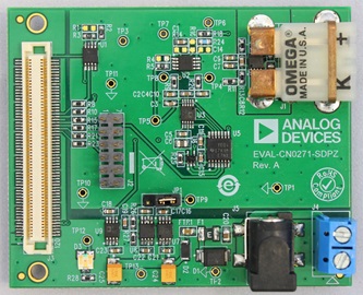

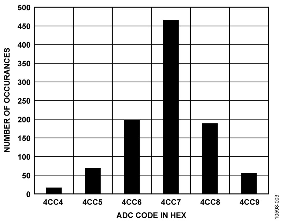

The noise performance of the system is also important to the accuracy of the circuit. Figure 3 shows a histogram of 1,000 measured samples. This data was obtained using the CN-0271 evaluation board connected to the EVAL-SDP-CB1Z System Demonstration Platform (SDP-B) evaluation board. See the "Circuit Evaluation and Testing" section for setup details.
The measured peak-to-peak noise is approximately 6 LSB (1 LSB = 4.9 V ÷ 65536 = 74.8μV), which corresponds to 0.449 mV pp and a noise-free resolution of 13.4 bits.
cn0271_img3
This shows that the converter is not degrading the noise-free resolution because the number of noise-free bits derived from the measured resolution at a fixed thermocouple input voltage is approximately the same as the number of noise-free bits predicted based on the theoretical output noise of the AD8495.
Figure 3. Codeword histogram for 1,000 samples at 120 Hz
