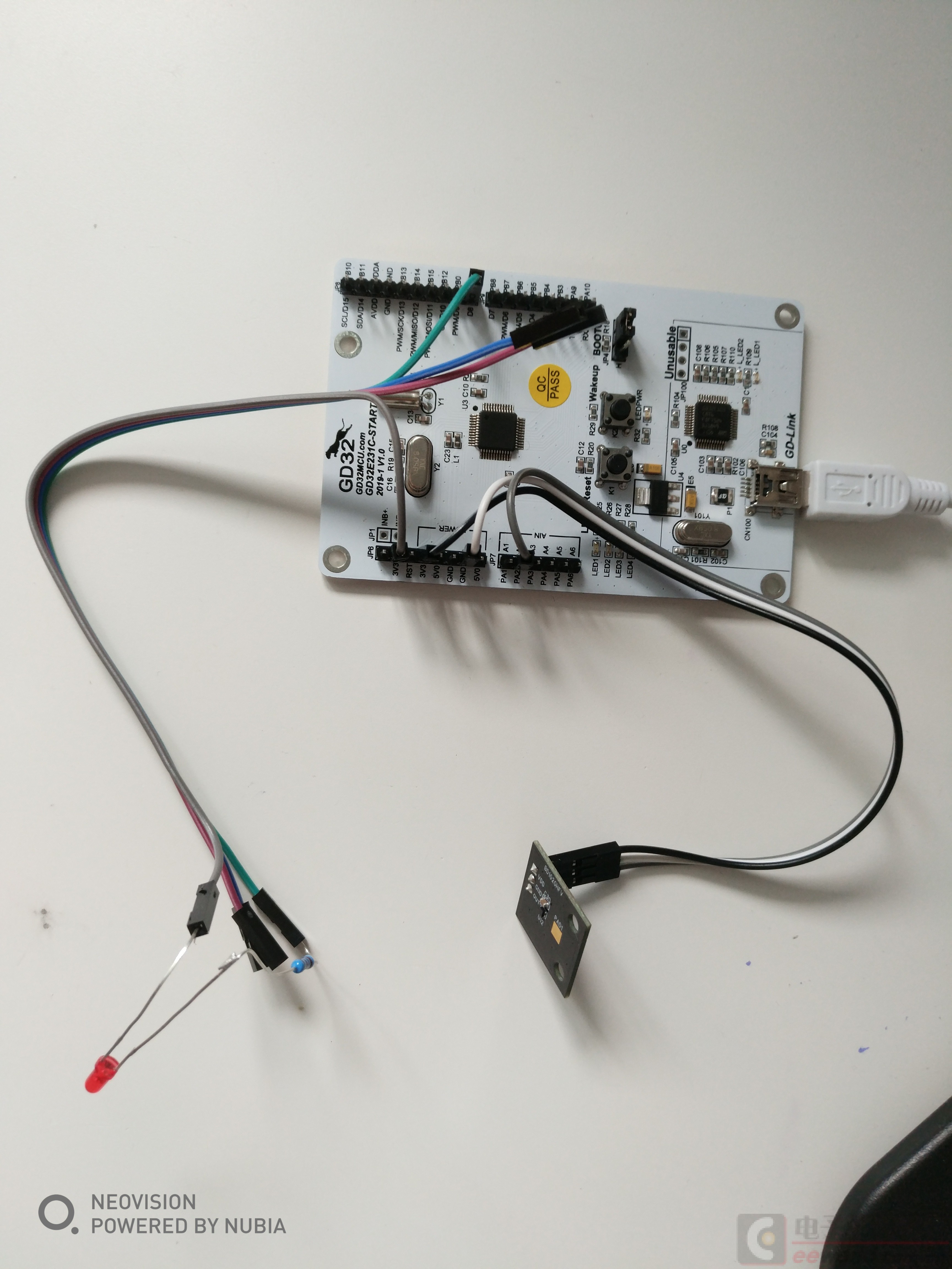

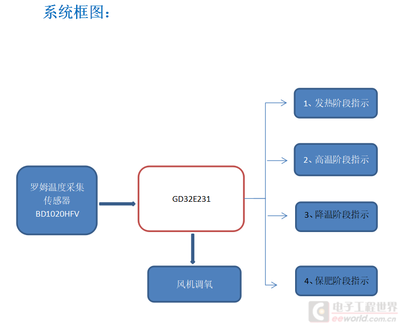

The temperature is used as the controlled variable in the fermentation process, the ventilation air supply volume is used as the manipulated variable to regulate oxygen, the GD32E231 microcontroller is used as the main control unit, and the output relay controls the fan to regulate oxygen. , through the design of hardware circuits and related application programs, the four processes of fermentation are adjusted to achieve the effects of accelerating compost maturity and improving fertilizer efficiency.
参考设计图片
Blockdiagram
