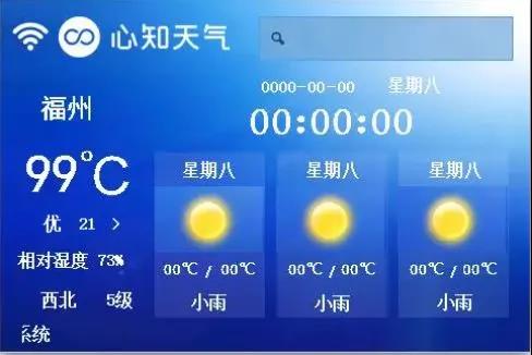

An intelligent desktop weather forecast system based on STM32, with voice recognition function, which can search for weather by voice and carry out simple conversations. It has the following functions:
-Real-time weather display, temperature and humidity display, calendar display;
-Air quality display;
-Radio function;
-Voice recognition function, you can search the weather by voice.
-Search weather using touch screen.

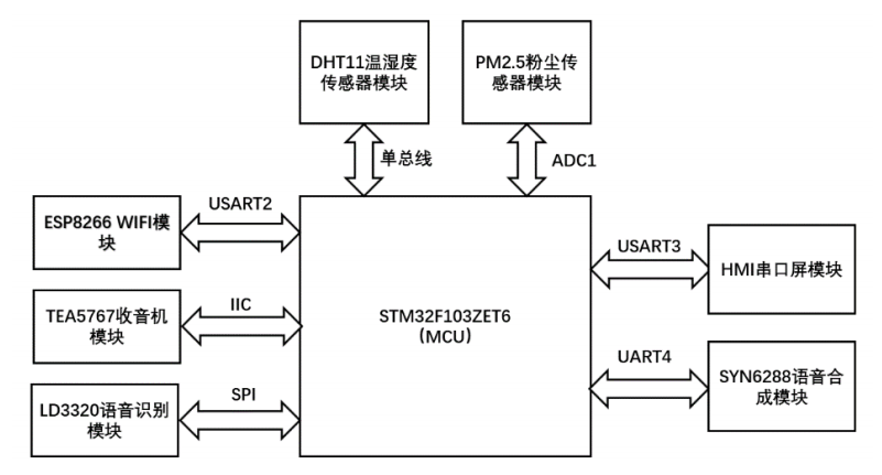

Blockdiagram
