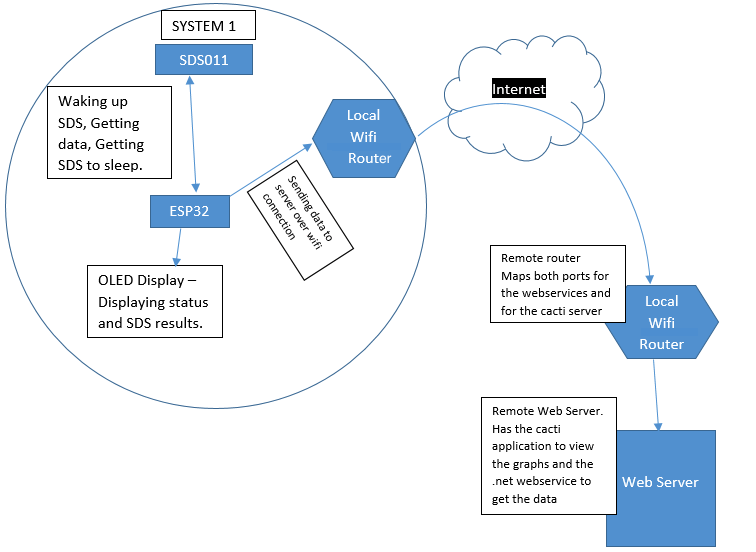

Nir Huri's device uses the SDS011 sensor to measure particulate matter. The device uses laser technology to determine PM2.5 and PM10 particle pollution levels by detecting light scattered by particles in the air. Espressif's ESP32, with its excellent onboard network capabilities, serves as the "brain" for Nir Huri device operation. This makes remote monitoring of the system easy, and the data will be uploaded to Cacti's system process, which will do the recording and plotting.
Blockdiagram
