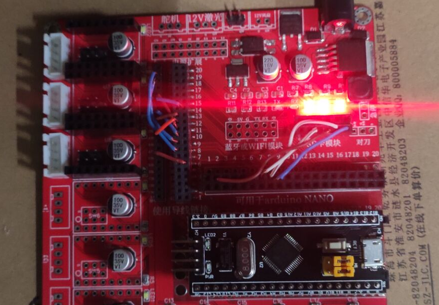

After making a development board based on Hangshun HK32F103C8T6 and drawing a CNC expansion board, this expansion board is used for early debugging. The attached HEX file is the 4-axis firmware. For firmware burning, please follow this Baidu network disk link to download the software and burning tutorial (link: https://pan.baidu.com/s/1OsqoGOvBfN4_68qm3qH0mQ extraction code: hdgr Copy this paragraph After opening the Baidu Netdisk mobile app, the operation is more convenient.) To burn HEX firmware, use the USB to TTL burning tool. Just connect 3V3V to 3V3 GND to GND RXD to PA9 and TXD to PA10.
