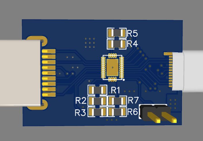

Why use VL160 when making a C female base? Look at the picture below.
VL160 is a chip that can identify the positive and negative insertion of Type-C female socket. You can do DFP and UFP, why do you need to identify the positive and negative USB plugs.
In other words, VL160 can only process data signals! It cannot process DP signals and PD. So I can only do 2lun, but not 4lun.
It can also be understood as processing the C public single-sided signal, and passing the single-sided signal in and out to the HUB chip.
VL160-QFN28 has CC recognition, two out of one, and can only process one set of signals.
