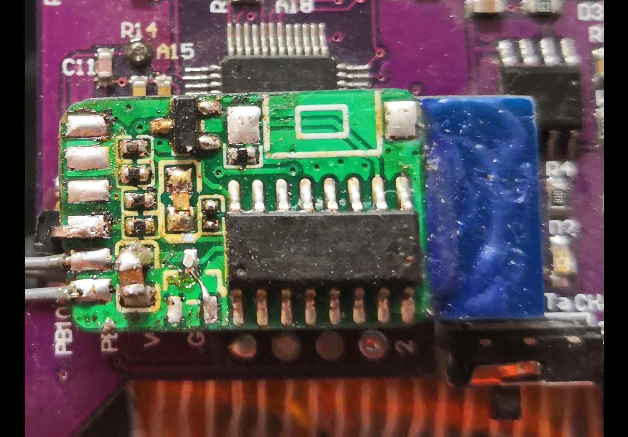

MINI Loli PPM/S.BUS receiver LOLI 3rd generation
  1. ^_^ Already tested on the board
  2. The current version has been replaced with small buttons, and it is more convenient to wrap the heat shrink tube
  3. Using patch wireless module
  4. If the input is 3.3V, there is no need to solder 662K, just solder a wire according to the cover to connect it.
  5. Both 1S input and 5V input need to be soldered 662K
  6. For good frequency, change the output mode of one channel to PPM to use PPM output. For S.BUS, change the 5th channel to SBUS output.
  7. PPM outputs 8 channels, as does SBUS
