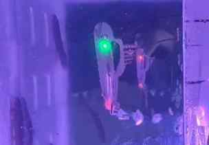

A development-free scene light socket firmware based on the Tuya WB3S module. I personally don’t know how to program, so I’m grateful for the development-free solution of Tuya Smart Platform. A reduction motor is responsible for transmission to rotate the submarine model, and an air pump is installed on the top of the hollow transmission shaft to add oxygen to the aquarium. Four enameled wires are installed inside the hollow drive shaft to power the boat-mounted RGB lights (the control pins of the boat-mounted RGB lights are deliberately disrupted to make the colors in the box richer). At the same time, the air outlet pipe at the stern of the boat is transparent. During the air outlet process, the air outlet is on the tail fin. The RGB lights will render the color of the bubbles.

There are three RGB lights designed on the boat, one on the left and right sides of the bow and one on the stern fin.
The thick red wire in the picture is drawn out to dissipate heat from the lamp.
