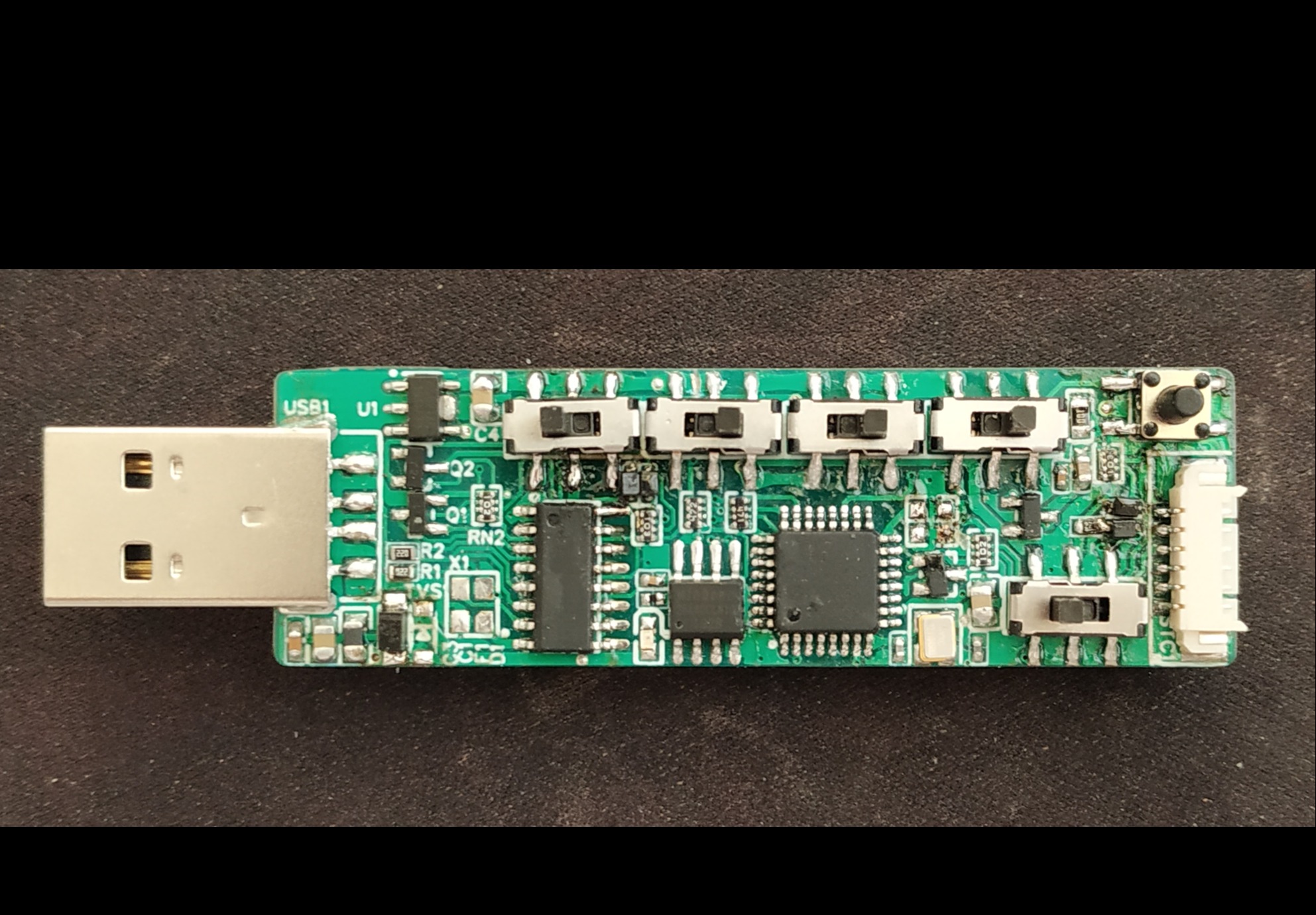

The STC51 and STM32 downloaders have been reduced in size this time to add a small-volume polymer lithium battery and a hardware manual cold start download switch. They hope to enable program downloading of all STC microcontrollers and integrate the STM32 microcontroller TTL one-click automatic download circuit.
Because it is a reintegration of the previous circuit, the working principle of the circuit will not be explained anymore. Here are the links to the STC51 downloader and STM32 one-click downloader:
STC51 downloader: https://maker.lceda.cn/p/583703056a/51-dan-pian-ji-xia-zai-qi
STM32 one-click downloader: https://maker.lceda.cn/p/583703056a/ch340c-stm32f103c8t7
The following mainly explains the lithium battery charging circuit and boost circuit:
Red circle 1 TP4057 lithium battery charging circuit, this chip has reverse connection protection
Red circle 2 PS7516 lithium battery boost circuit, the output voltage setting should not be higher than 5V
Red circle 3 automatically turns off the lithium battery boost circuit when plugged into USB for charging
Red circle 4 is a switch that controls the lithium battery boost. Its function is to turn off the 5V boost when not charging to save the power of the lithium battery.
Several toggle switches are added to the downloader. SW1 is an upgrade switch for the STC51 offline downloader.
SW2 is the STC51 downloader's automatic download and manual download switch for external microcontrollers.
SW3 is the offline download trigger switch.
SW4 is a switch used to select whether to supply 5V or 3V power to the external STC51 microcontroller.
SW5 is a manual cold start download switch for the STC51 microcontroller.
PCB blank board
TOP Layer:
BOTTOM Layer:
Welded PCB board-TOP Layer:
Welded PCB board-BOTTM Layer:
