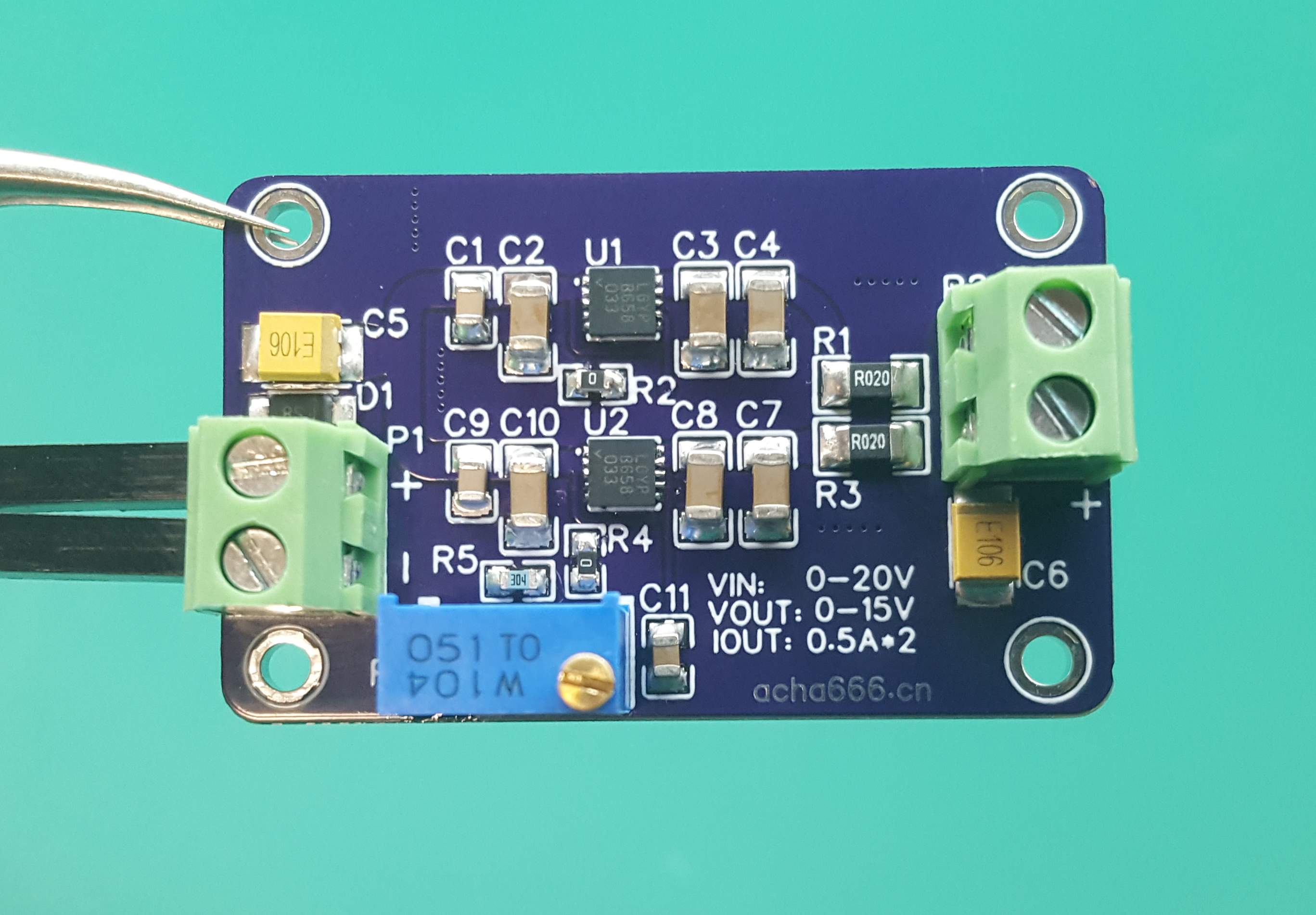

LT3045 ultra-low noise LDO verification board
characteristic
  • Input voltage range 1.8-20V
  • Output voltage range 0-15V
  • Voltage difference 260mV
  • Output current 2*0.5A
  • Ultra-low RMS noise: 0.8µVRMS (10Hz to 100kHz)
  • Ultra-low shot noise: 2nV/√ Hz (at 10kHz)
  • Ultra-high PSRR: 76dB (at 1MHz)
  • Few peripheral originals
  • Quick start function (not implemented)
  • Internal current limit
Introduction
  • Using DFN 3*3mm package, dual parallel LT3045 design
  • Reverse connection diode protection
  • R2 and R4 are current limiting resistors and can be short-circuited directly if current limiting is not required.
Notice
  • The two tantalum capacitors C5 and C6 are limited by the package size and can only choose 25V withstand voltage, which does not provide enough redundancy.
application
  • Power supply for precision voltage and current reference
  • Other application scenarios requiring low ripple and low noise
Noise test
Figure 1 below shows the waveform at the input filter capacitor, Figure 2 shows the output capacitor waveform.
The noise is smaller than the noise floor of the oscilloscope
