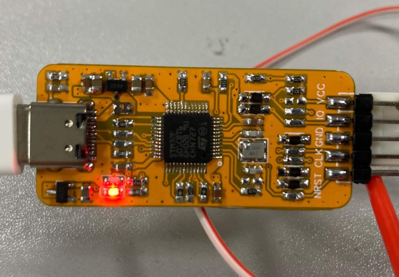

Standard V2 version, preliminary proofing and testing has been carried out; supports SWD and SWIM interfaces, STLink V2.J16.S4 version firmware: attachments have been uploaded.
Burn firmware
  1. Use existing ST-Link/J-link to burn the V2.J16.S4. firmware in the attachment;
  2. Connect USB. USB devices can be recognized at this time, but Keil/IAR/STVP, etc. may not be available. You need to use ST-LINK Utility to update the new ST-Link firmware. The current version (2021.1.20) is V2J37S7;
  3. After the update is completed, comprehensive testing and verification must be carried out before it can be used.
Questions to be improved:
  1. Package/model selection of PTC insurance, the current package is not easy to weld;
  2. Since the external power supply and the debugger power supply are independent, if the target board is not powered, jumpers are required. The current pin layout is inconvenient for jumpers and will be adjusted in the next version;
Version Information:
Version 1: STLink V2.J16.S4 version firmware: Standard V2 version, supports SWD and SWIM interfaces, this version of firmware is. Attachment uploaded. Version 2: STLink V2.J28.M18 version firmware: used for ST-LINK/V2-1, ST-LINK/V2-A, ST-LINK/V2-B boards (with STM32 debugging interface, large-capacity storage interface, virtual COM port) version
