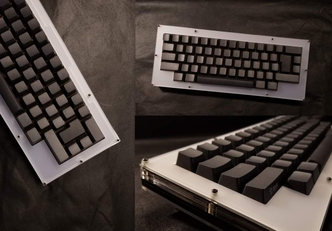

Structural gasket, generally the gasket uses foam to clamp the positioning plate to achieve a soft elastic effect.
This project uses the deformation of the PC positioning plate to achieve the effect (it is very elastic, and I personally think it feels great)
I don’t know much about electrical knowledge. For the schematic diagram, please refer to Laoxuan 87v1 (thank you)
PCB is designed by ourselves, and the board is printed and verified to be correct.
Currently known minor issues:
1. Since the PCB and the positioning board are only fixed by the hot-swappable shaft, the edge of the space deforms greatly, and the shaft looks easy to loosen (no major problems were found in actual use).
It is recommended to install a five-pin axis or add copper pillars between the positioning plate and the pcb (need to change the drawing and pcb)
2. The pcb board should be rotated to the left or right when moving to the left and entering the position. Like other key positions, the positioning plate will not be able to fix the shaft body (the five-legged shaft can also be used)
3. The shift key should be divided into 1.75U plus 1U key positions. It was stupid when I did it.
Relevant documents will be sorted and uploaded in time.
