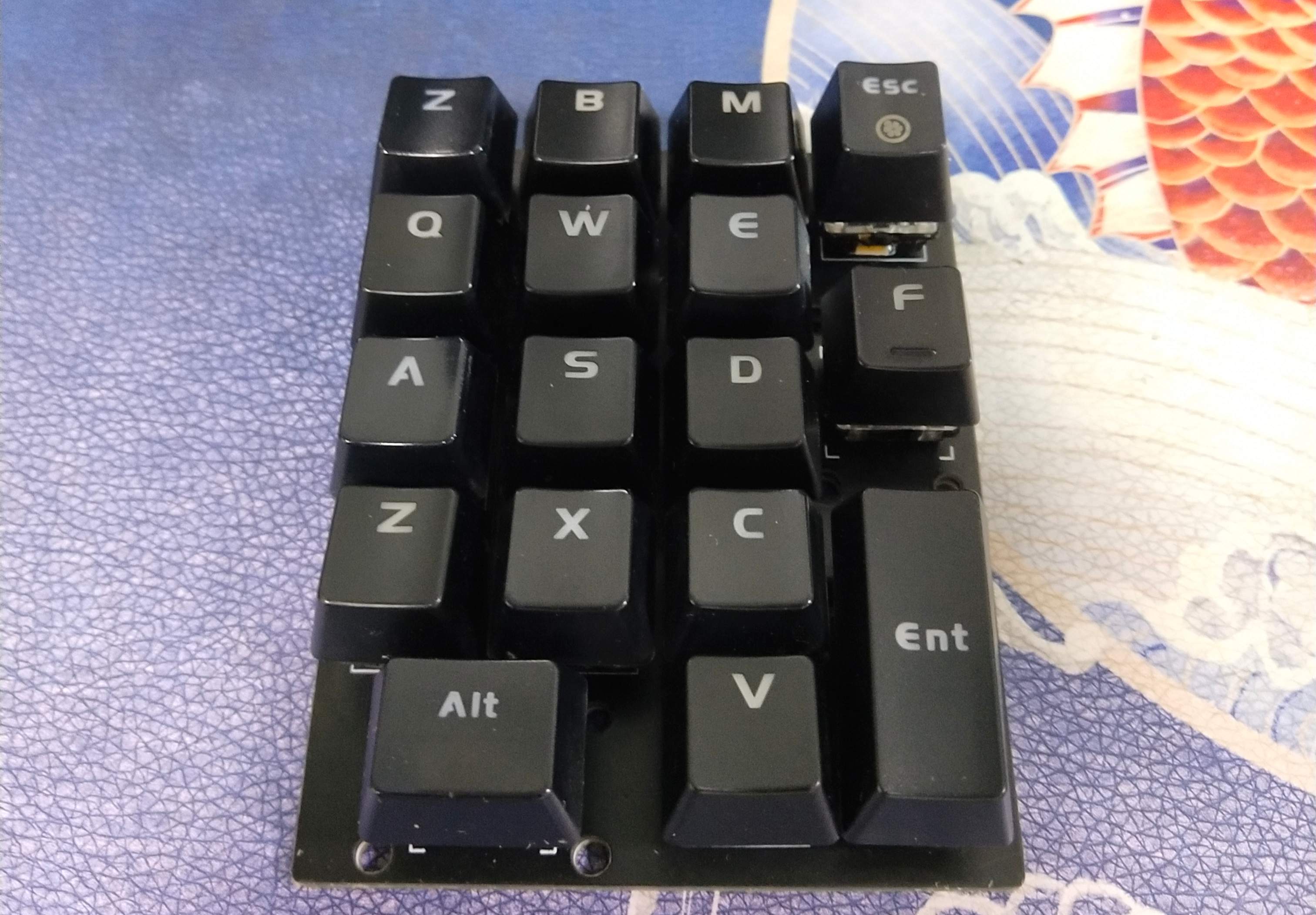

9. Appearance
The base is glued together using another piece of board and hot melt glue.
Considering that the jp next door has a 3D printing activity for free, I may paint the shell in the future.
2021/6/15 I can’t afford to play next door, I can’t buy 3D printing for free, and the shell will not be painted.

The last two comments are that the feel of the black switch is really bad. Who is it that said that the black switch is suitable for gaming?
