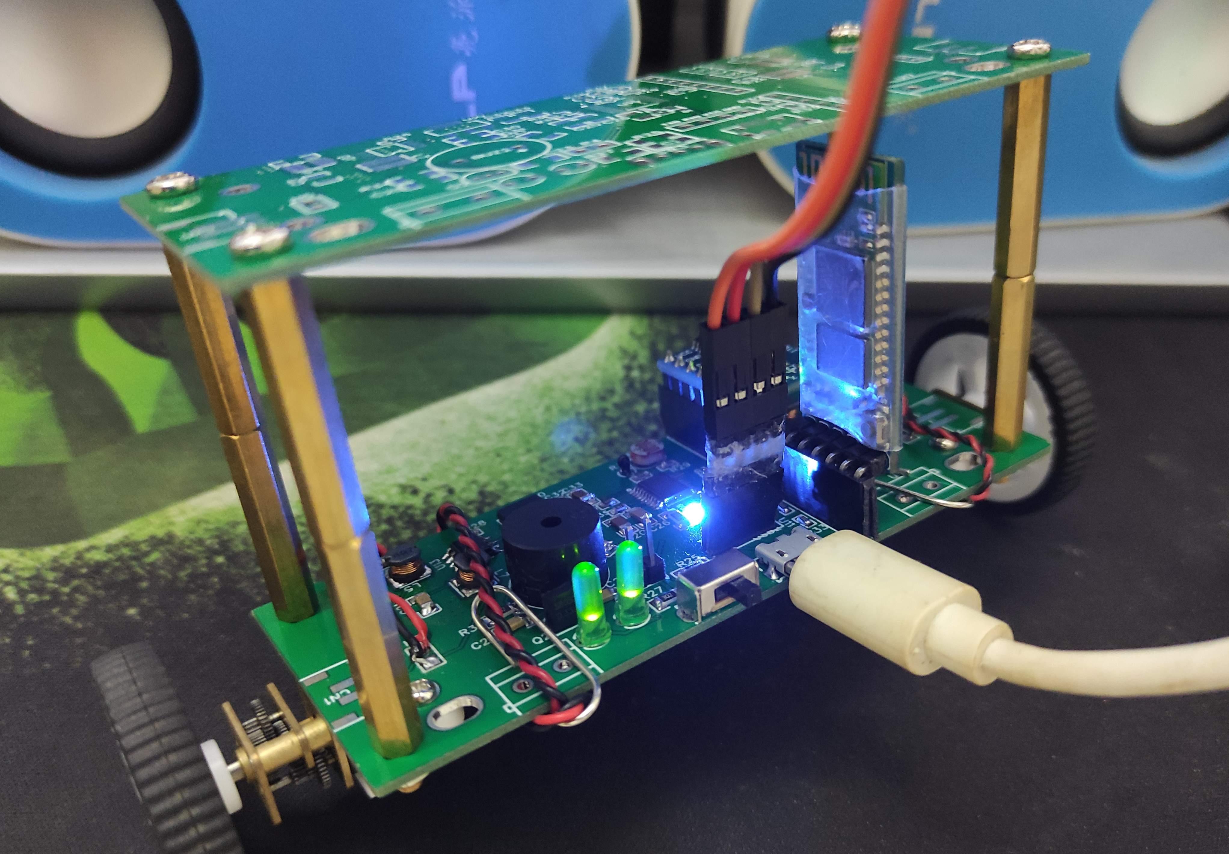

The balancing car is based on stc8g1k17 tssop20
PCB board integration:
  • e2prom: AT24C16
  • Dual motor drive: TC118S
  • Bluetooth module interface: HC-05
  • Gyroscope module interface: MPU6050
  • Serial communication & download interface: CH340
  • 5V buzzer circuit: P6.50 5V
  • Photoresistor, thermoresistor: GL5537 MF52
  • The total cost is less than 30 yuan [If it’s expensive, go to Taobao]
Remarks: ** [Motor: N20 Matching wheel: miniQ 34mm Motor base: N20 motor base 2511.511.5 (m2 fixing hole 2)]*** 001.png~~~~
