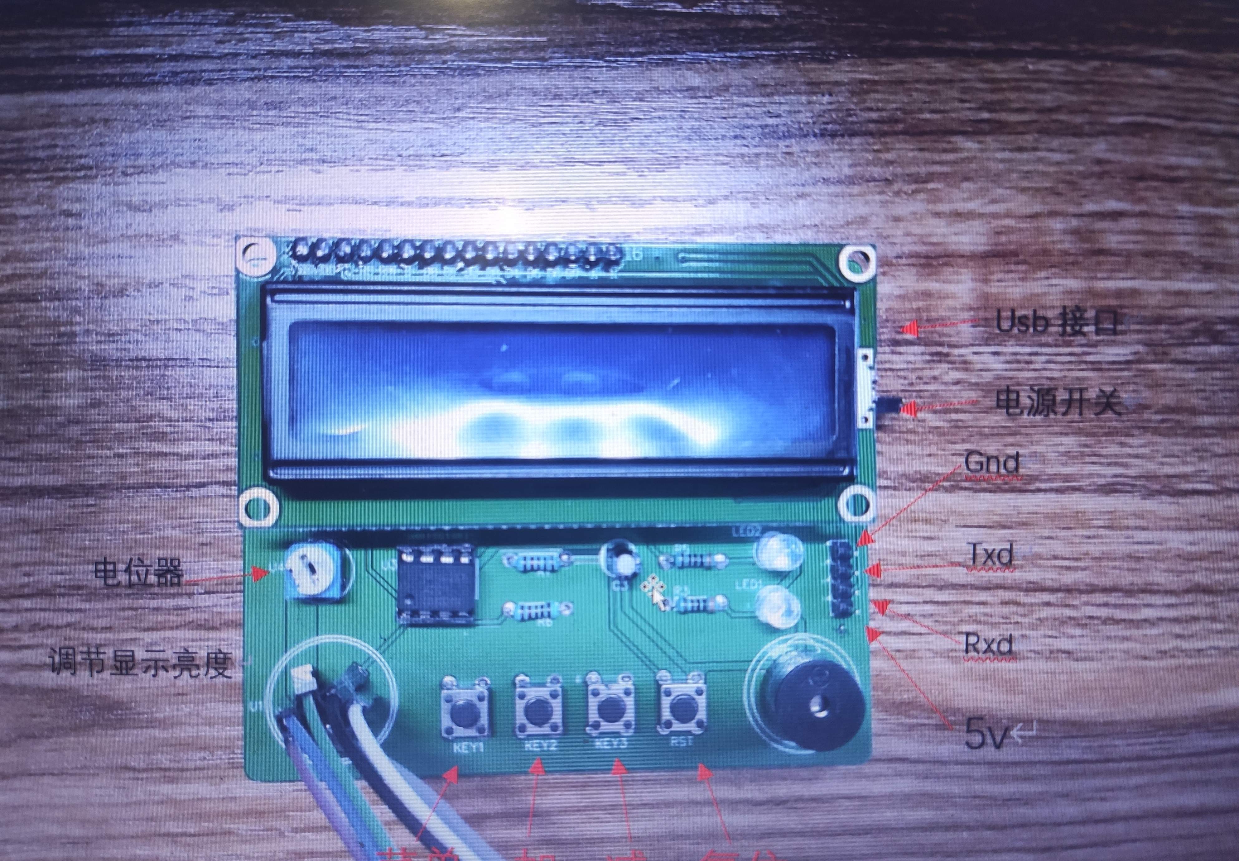

Instructions for use: After powering on, it needs to be preheated for a period of time. At this time, the LCD displays Loading... (the preheating process is changed to the voltage rising first and then falling, and the voltage is detected to detect whether the preheating is completed). After the preheating is completed, Display alcohol concentration, press key1 to enter the alarm setting mode, press key2 to increase, key3 to decrease, press key1 again to exit the alarm setting mode (key2 and key3 must be in the alarm setting mode to work)
