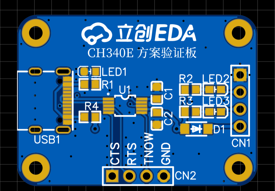

PCB description
  • This project is a CH340E verification solution board, which leads out all the IOs of the CH340E; the serial port IO uses a 4-pin pin header to lead out separately. Nowadays, the use of Type-C interface is basically popular, so this design uses Type-C as the USB interface;
  • The four positioning holes on the board are suitable for M2 copper pillars. The distance between the center holes of the long side copper pillars is 30cm, and the distance between the center holes of the short side copper pillars is 20cm;
