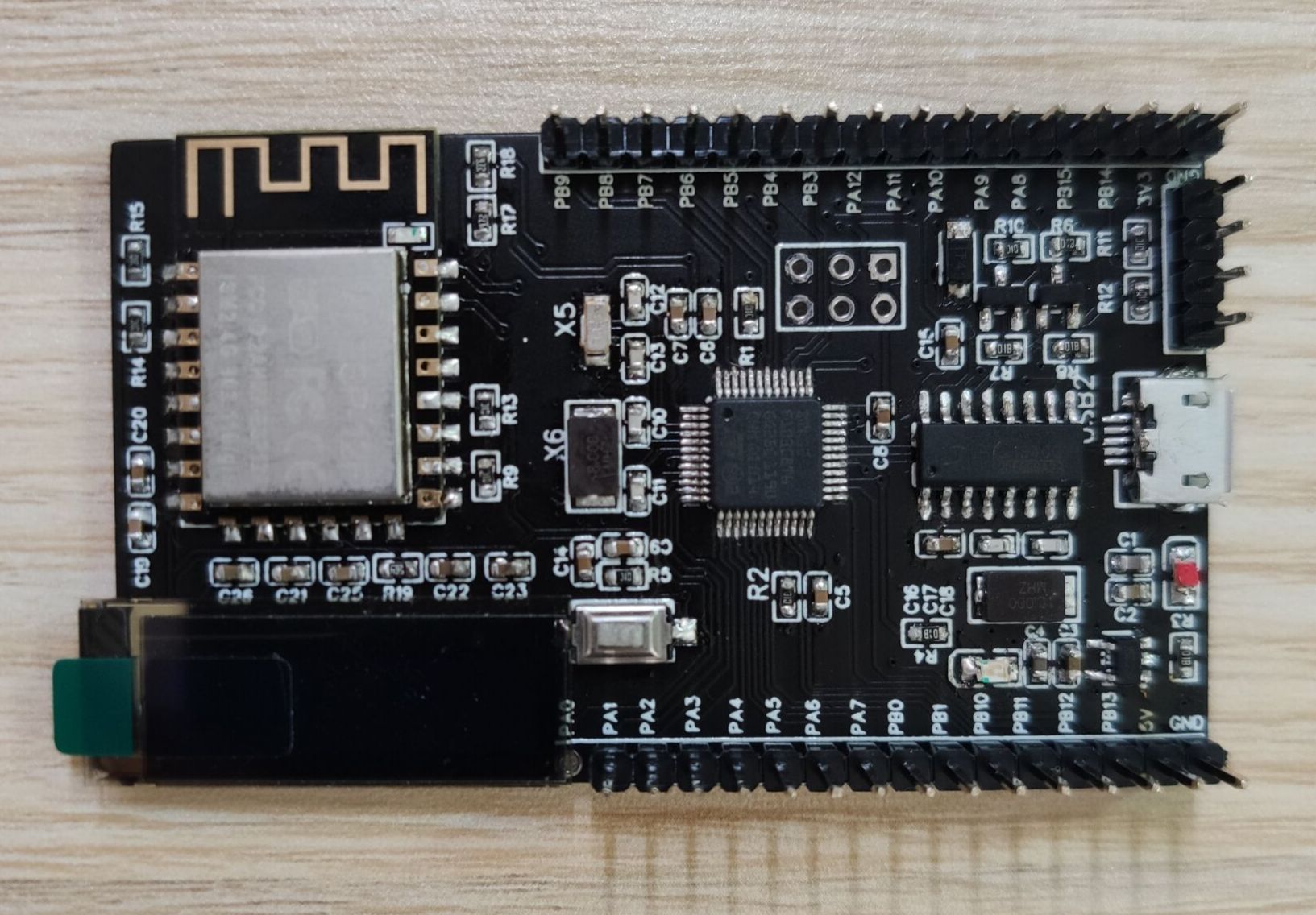

Since the power supply part was designed incorrectly during the first version of the design, causing a short circuit and causing smoke, the IoT development board designed in the basic class was used to complete this design.
