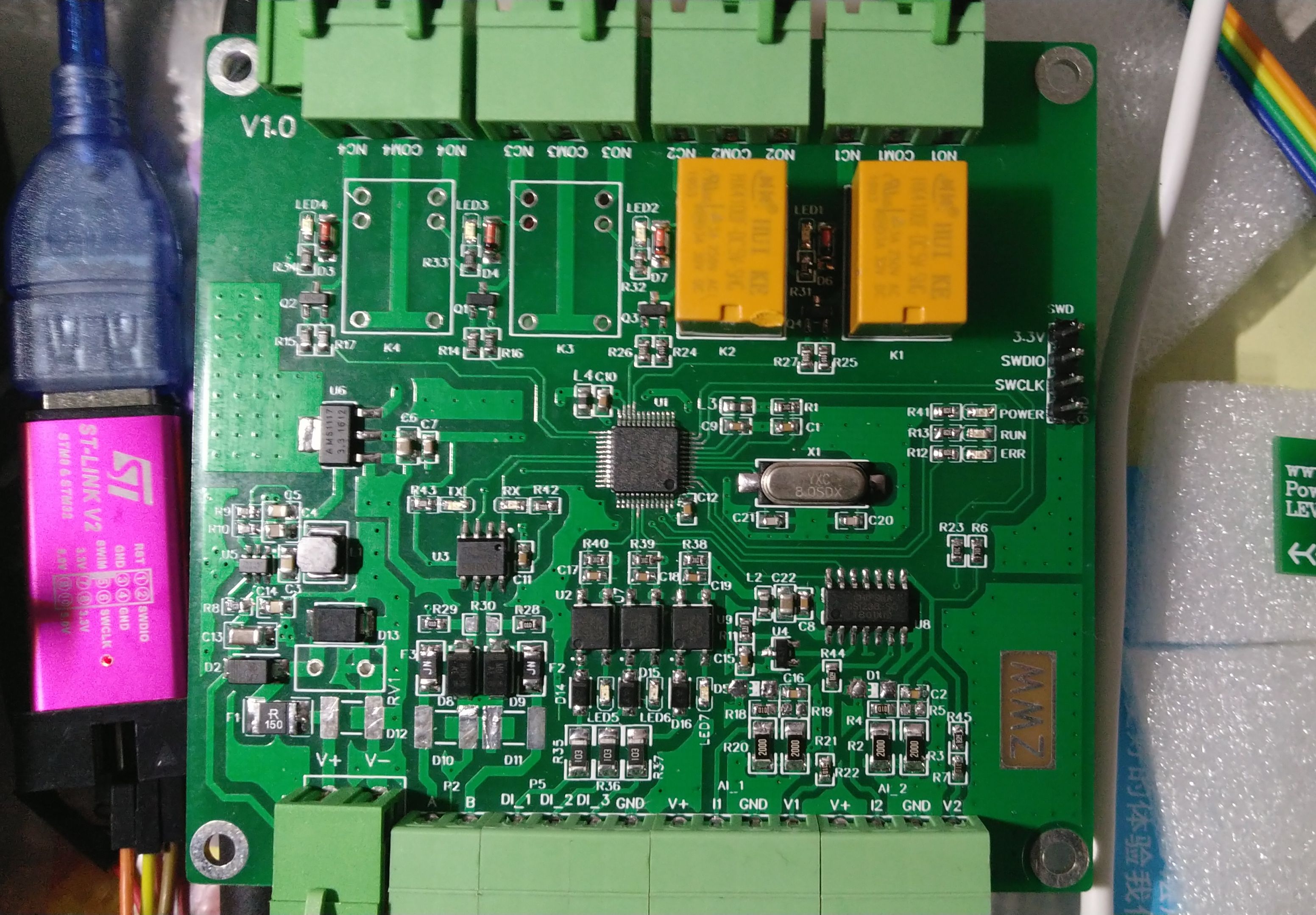

The module can collect 4-20mA or 0-10V analog signals, has 24-bit resolution, is connected to PLC or host computer through modbus protocol, and has programmable upper and lower limit relay output functions. Adopting Free RTOS real-time operating system, programmable ADC acquisition frequency, 485 interface and power interface adopt lightning protection and anti-surge design. Wide voltage input range, up to 4.7 to 40V voltage range. It is very convenient in certain situations, such as water level control. When the water level reaches a low level, the water pump is started to add water, and when the water level reaches a high water level, the water pump is turned off.
Thanks again for Lichuang’s support
PCB and components are back and ready to go
Go to the workbench
Solder peripheral components first
Then weld the STM32 microcontroller
Finally weld the straight plug-in
The welding work is basically completed
Finally, wash it with washing water
PCB also needs face, right?
Here's a close-up
