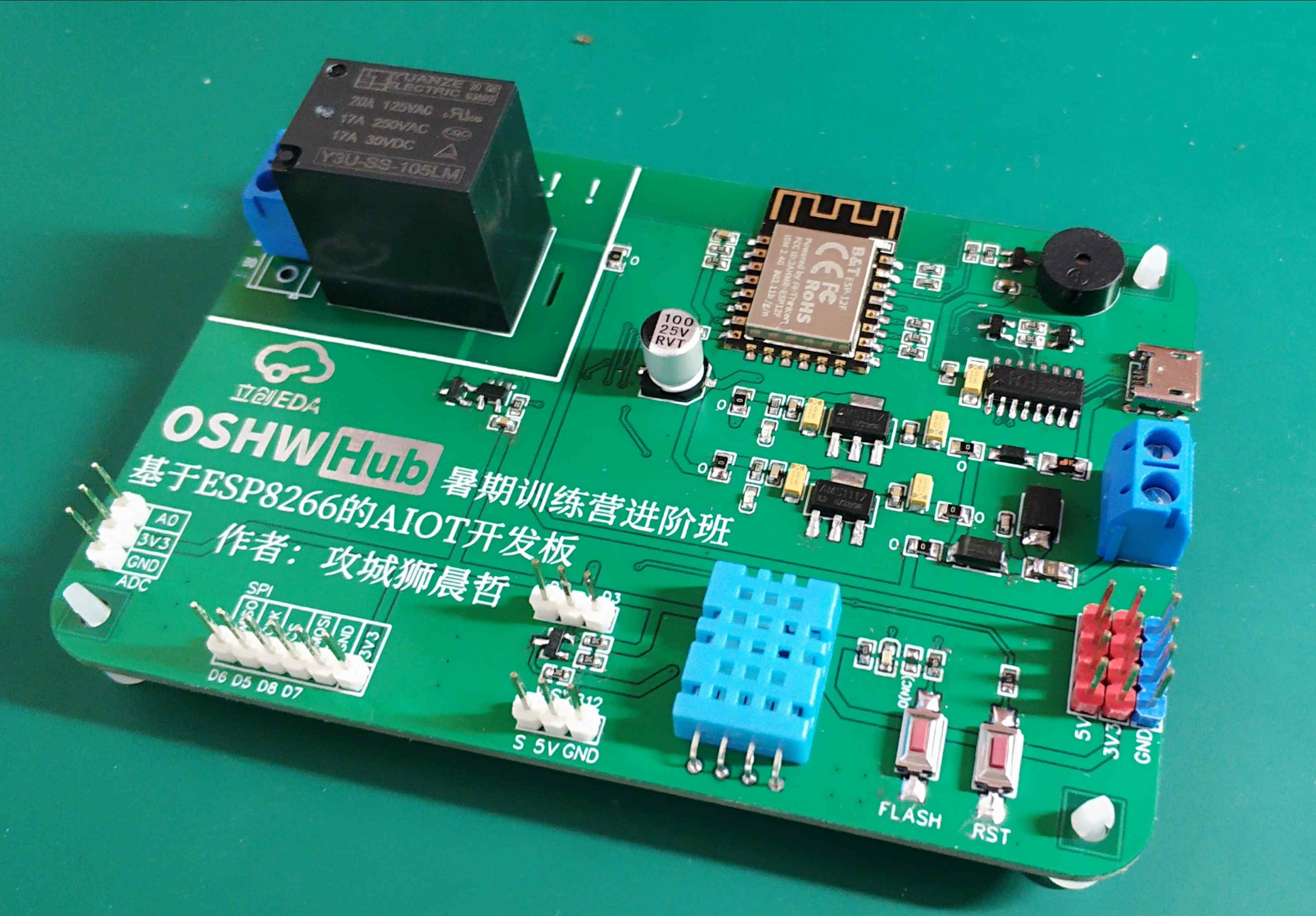

Welding debugging
1. Take a photo as a souvenir
2. Weld the power supply part first. After the power supply part is soldered, use a multimeter to check whether there is a short circuit. If there is no short circuit, power on and test. If both power indicator lights are on, it means the power supply part is normal.
3. There is no problem with the power supply. Solder the jumper resistor between CH340 and the power supply part.
4. After welding the CH340, connect it to the computer to see if the CH340 can be detected. The computer has recognized the CH340 device, which means the circuit is normal.
5. Next, weld the automatic download circuit and ESP8266 core module
6. Connect to the computer for testing. The program can be burned normally and the ESP8266 minimum system is normal.
7. Solder other components. The final board is as shown in the picture below.
8. Tin piling treatment on the window opening part
Note: This part of the picture uses version V0.1.
