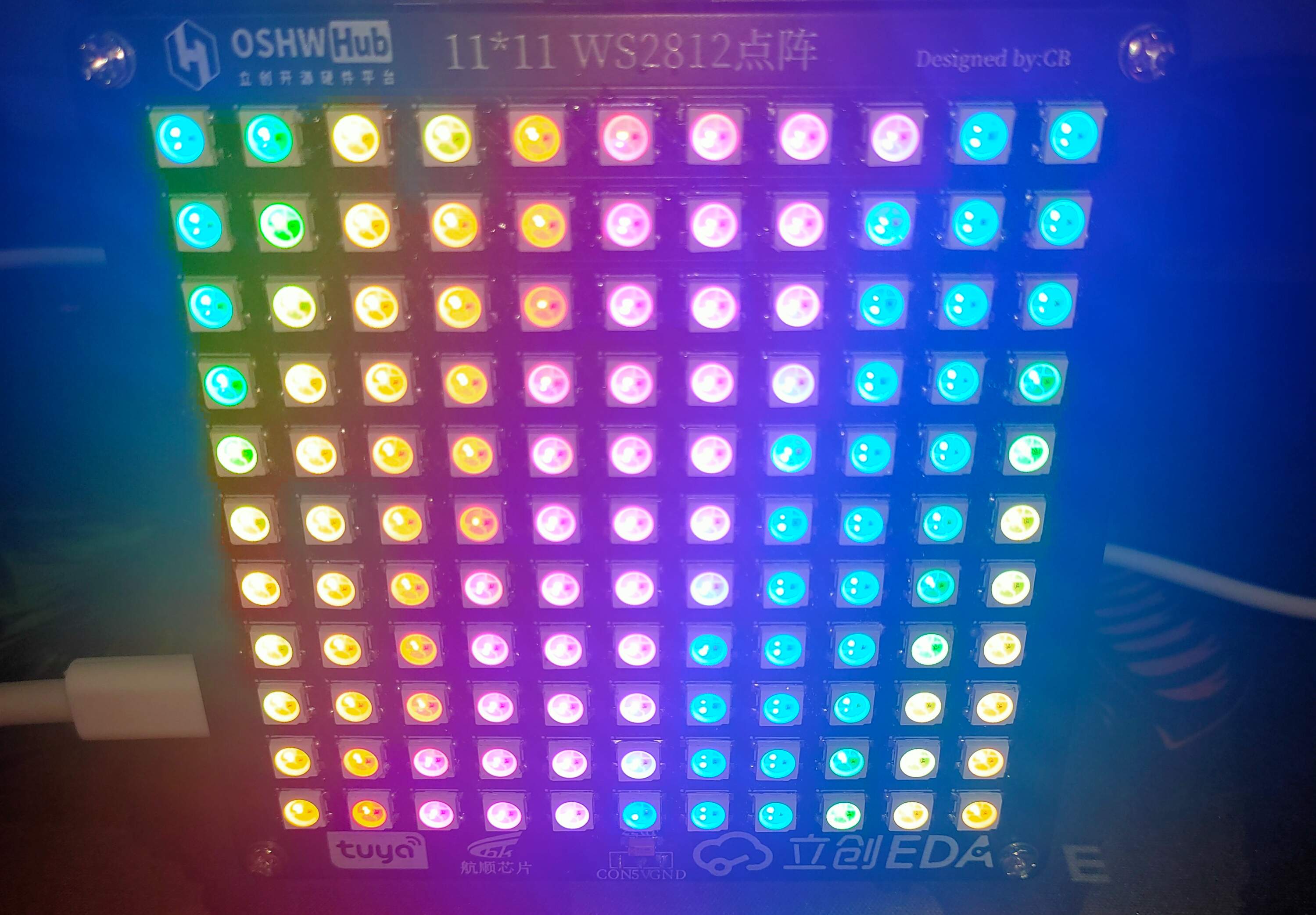

Using the WS2812 matrix light board controlled by ESP8266, the front panel can be used for other purposes. The onboard DHT11, photosensitive sensor, HK24C16, DS3231, Tuya CBU module can be used to develop clock light projects.
*2. Project attributes
original project
* 3. Open source agreement
GPL3.0
*4. Hardware part
Use Easy EDA to draw, the light board is connected to the main control board through pin headers, the control pin is IO2, and one of the buttons corresponds to IO16.
*5. Software part
Use arduino IDE for programming. The source code is in the attachment. If you want to use Tuya remote control, you need to change the PID yourself. If you don't need a Tuya chip, just burn it directly and switch the lighting mode by pressing the button.
