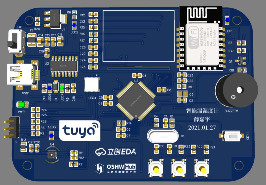

[Tuya Smart] Thermohygrometer based on Tuya Smart
image.png         This project is designed based on the WB3S module of Tuya Smart. The main control chip is STM32L071, and the USART2 of the MCU is used to communicate with the Tuya module. The indoor temperature and humidity meter in this design uses the high-precision digital temperature and humidity sensor SHT30 and uses the MINI-USB port for power supply. After the board is powered on, each hardware is initialized. When the WB3S module is successfully configured, the LED light on the right side is always on. The MCU transmits temperature and humidity data to the WB3S module and USART1 port. image.pngimage.png
