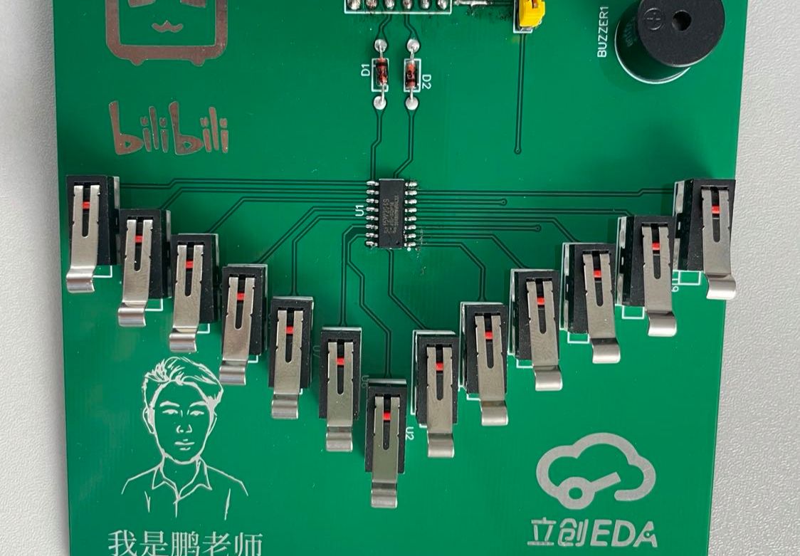

Project rendering:
Software source code
#include "stc15.h"
#define MAIN_Fosc 24000000 //Clock frequency 24M
typedef unsigned char u8;
typedef unsigned int u16;
typedef unsigned long u32;
sbit P_PWM = P1^4; //PWM pin
u16 PWM_high;
void Pin_Init()
    P1 = P3 = P5 = 0xff;
    P_PWM = 0;
    P1M1 &= ~(1 << 4);
    P1M0 |= (1 << 4);
u16 cur_tune = 0; //Used to record the current frequency
void PWM_SetTune(u16 tune)
    cur_tune = tune;
    if(tune == 0)
        TR0 = 0;
        PT0 = 0;
        TMOD = 00;
        TMOD = 0;
        INT_CLKO = 0;
        P1M0 = 0;
        P_PWM = 0;
    else
        EA = 0;
        PT0 = 1;
        P1M0 |= (1 << 4);
        TR0 = 0;
        PT0 = 1;
        TMOD &= ~0x03;
        TMOD &= ~0x04;
        INT_CLKO |= 0x01;
        PWM_high =65535UL - 1000000UL/tune;
        TH0 = (u8)(PWM_high >> 8);
        TL0 = (u8)PWM_high;
        TR0 = 1;
char last_value[13]= {1,1,1,1,1,1,1,1,1,1,1,1,1}; //Record the last key value of 13 keys
char now_value[13] = {1,1,1,1,1,1,1,1,1,1,1,1,1}; //Record the current key values ​​of 13 keys
//The frequency corresponding to each key uses the five-tone interface
u16 tune[13] = {262, 294, 330,392,440,523, 587, 660,784,880, 1046,1174,1318};
void main()
    int i = 0;
    Pin_Init();
    PWM_SetTune(0);
    while (1)
        now_value[0] = P10;
        now_value[1] = P37;
        now_value[2] = P11;
        now_value[3] = P36;
        now_value[4] = P12;
        now_value[5] = P33;
        now_value[6 ] = P13;
        now_value[7] = P32;
        now_value[8] = P15;
        now_value[9] = P31;
        now_value[10] = P54;
        now_value[11] = P30;
        now_value[12] = P55;
        for(i=0; i<13; i++)
            if(last_value[i] != now_value[i]) //
                if(now_value[i] == 0)
                    PWM_SetTune(tune[i]);
                else if (cur_tune == tune[i])
                    PWM_SetTune(0);
                last_value[i] = now_value[i];
        if( (last_value[0] == 1) &&
            (last_value[1] == 1) &&
            (last_value[2] == 1) &&
            (last_value[3] == 1) &&
            (last_value[4] == 1 ) &&
            (last_value[5] == 1) &&
            (last_value[6] == 1) &&
            (last_value[7] == 1) &&
            (last_value[8] == 1) &&
            (last_value[9] == 1 ) &&
            (last_value[10] == 1) &&
            (last_value[11] == 1) &&
            (last_value[12] == 1))
            PWM_SetTune(0);
