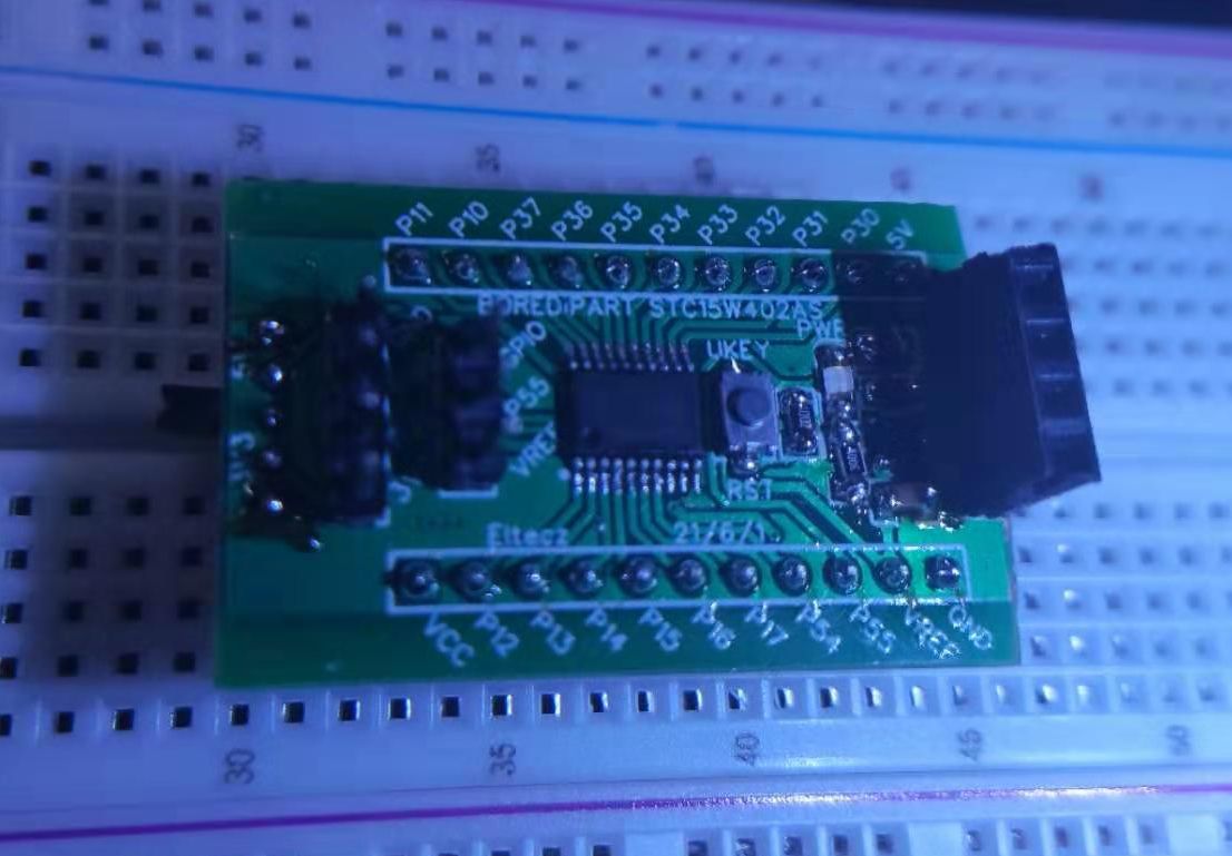

As usual, I got a few 15W402 chips and made a development version.
Several sets of pin headers are reserved. The top and bottom are all IO ports. The leftmost is the download port. Use a jumper cap in the middle to modify the P55 function to be Vref or GPIO. The right side is the OLED interface of the IIC protocol. The levels have been prepared. Conversion processing
The switch on the left is to control the operating voltage of the microcontroller. When it is only powered by the download port, please turn the switch to 3V3.
The board comes with a power indicator light and user/reset button, and the functions are switched by STC-ISP
PCB is compatible with 600mil DIP package and can be plugged into various development boards (?)
Please see the schematic diagram for specific precautions.
The physical diagram is different from the PCB diagram due to the use of the super invincible puzzle method.
Similarly, due to paneling, the PCB does not display component numbers.
