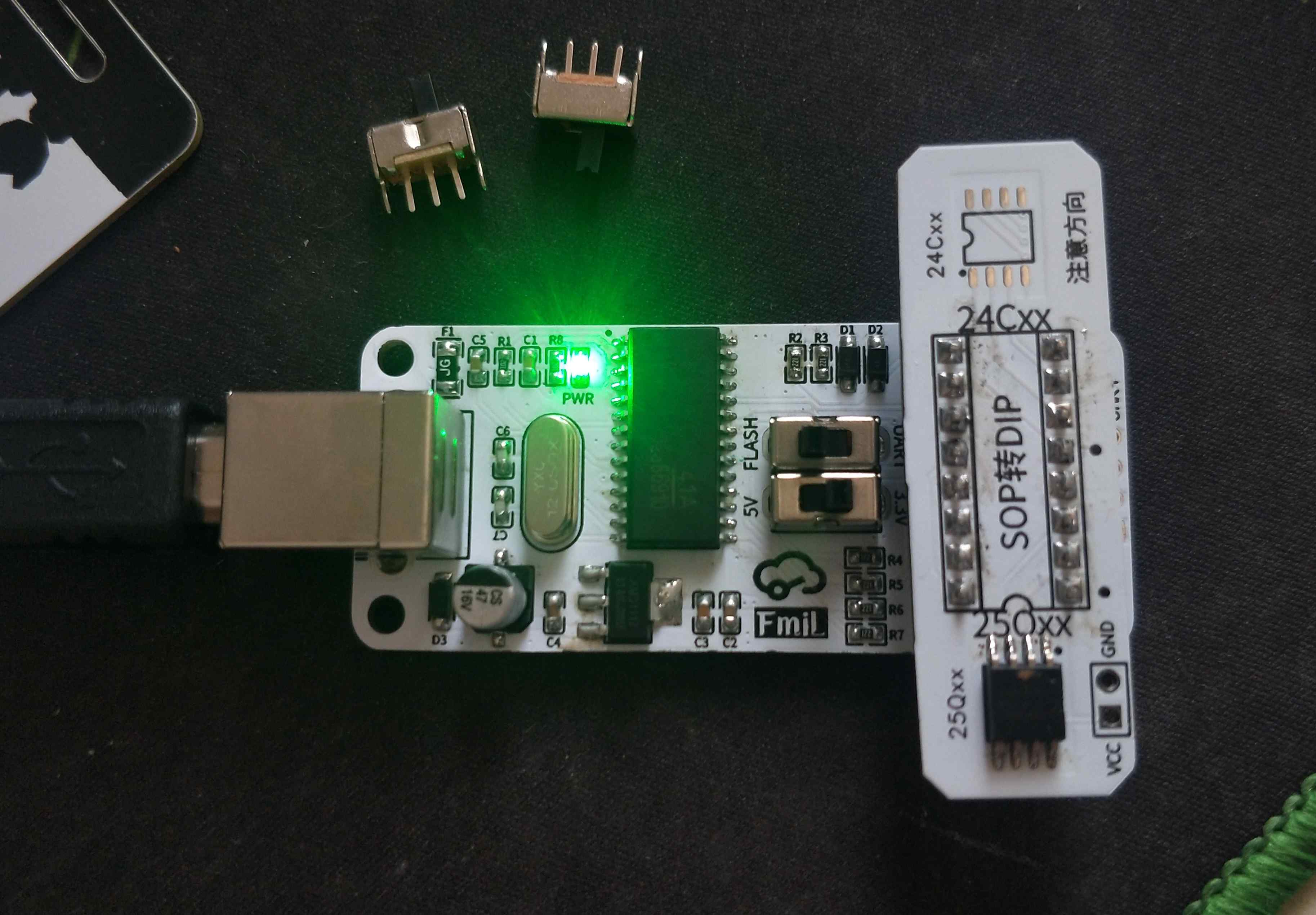

Use the toggle switch to select the function and output voltage. There are normal serial port mode and memory burning mode.
For SMD flash chips, an adapter board is required. The adapter board has been added to the pcb. How about the * version? , you can use it after breaking it apart, and then polish it slightly. Considering that the adapter board may be welded repeatedly, do not choose a board that is too thin.

2020/7: Proofing ready, waiting for verification
2020/8: Verification successful. The effect is as shown in the figure
Take out the data cable you picked up
Set the toggle switches to FLASH and 3.3V respectively, and power on directly for testing. If you hear the sound of the device connecting, open the device manager and take a look.
is an expected result. Please use "Double-click this installation" in the first folder "XP, WIN7.WIN8 Driver" in the attachment.
It shows that the installation is successful. Re-plug and unplug it. Then open the device manager and it has been successfully recognized. Open the CH341A.exe in the attachment and you can see "Connected" in the lower right corner.
Let's take out a flash that we don't know where to remove and pay attention to the pin alignment.
Then weld on
Install the programmer board
Click "Detect" on the software and you can see that the manufacturer's model capacity information has been read out.
Let's hit read and see what's inside
It actually has the word Lenovo on it. .
