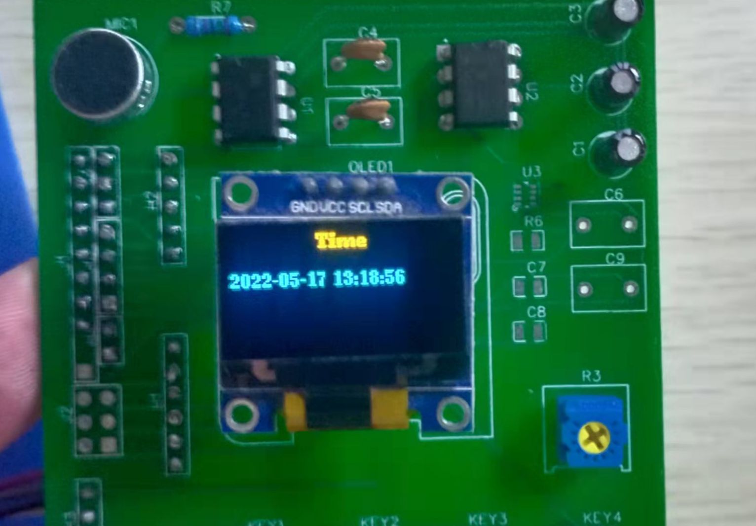

Let’s take a look at the picture below
This is the time display in status 1
This is the noise and temperature of state two
This is the atmospheric pressure and relative altitude of state 3
