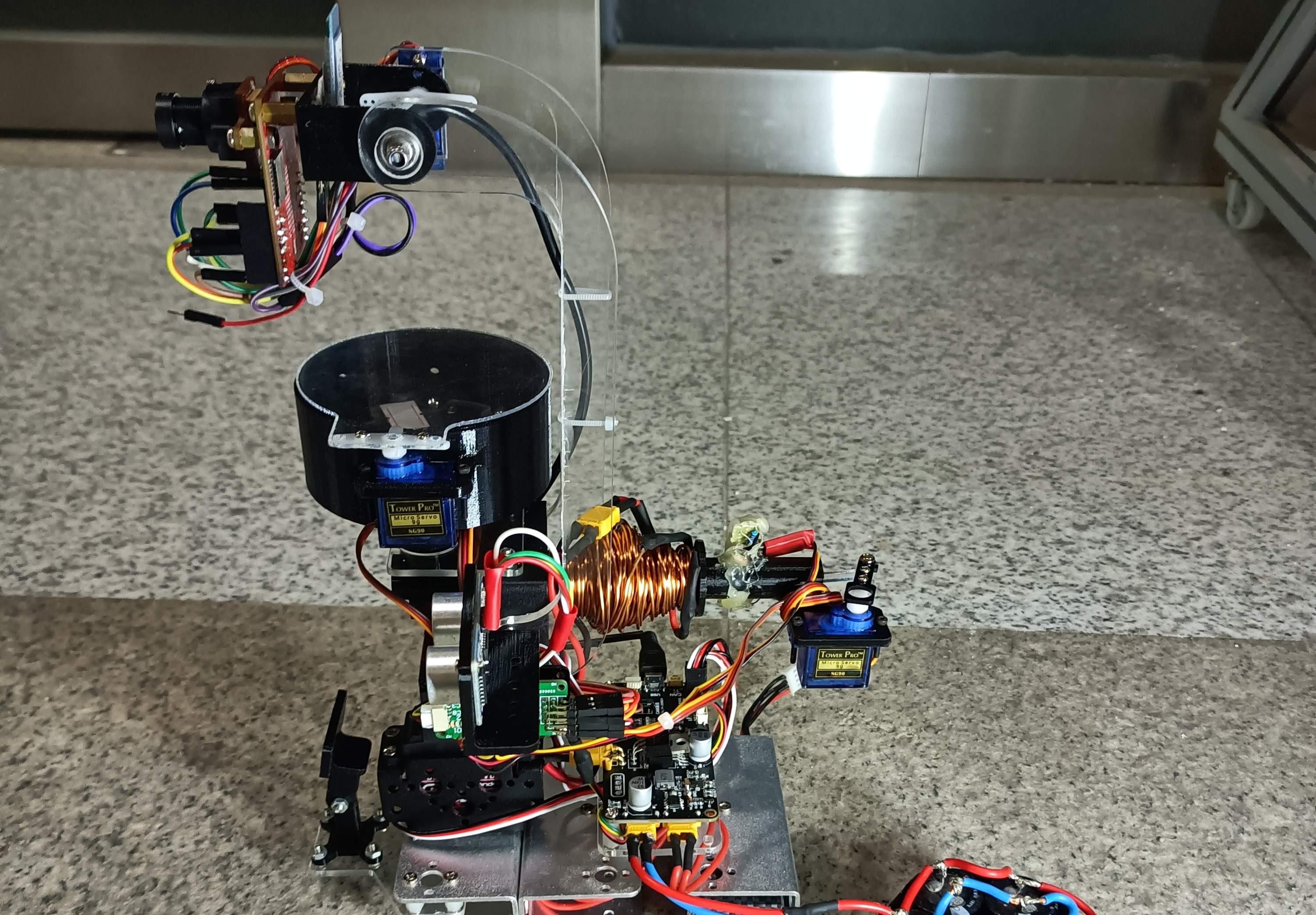

The 2019 question H electromagnetic gun can be said to be a comprehensive question involving circuits, analog electronics, and control. The most difficult part is the stability and accuracy of the electromagnetic gun launch. The key to the stability design lies in the selection of the MOS tube or relay (however, because the MOS was often burned at the time, for the sake of stability, I ended up using the MG996 servo to control the mechanical switch in the 2019 competition), while accuracy requires attention to the gun. The design of the tube should try not to allow bullets to collide inside the barrel, and of course, ensure the stability of the capacitor voltage (it turns out that the unstable impact point is due to the leakage of the electrolytic capacitor causing fluctuations in the launch voltage).
The picture below shows the actual electromagnetic gun I made in 2019:

In order to realize automatic loading, this system has designed a magazine to store projectiles, and also designed a servo dial so that projectiles can drop from the top of the platform into the barrel. The effect is as follows:
In order to better match different firing voltages, this system designed an innovative barrel. The barrel integrates a single-point laser for aiming, and a servo pushrod to match different capacitor voltages to increase launch distance and improve energy efficiency; a photoresistor interface is also reserved to monitor in real time whether there are residual bullets.
In terms of coil design, since this device is a low-voltage version and has a large output current, the diameter of the coil needs to be larger (more than 10mm). To generate a stronger magnetic field, we only need to increase the number of turns of the coil (the middle part of the coil can be wound with a few more layers)
