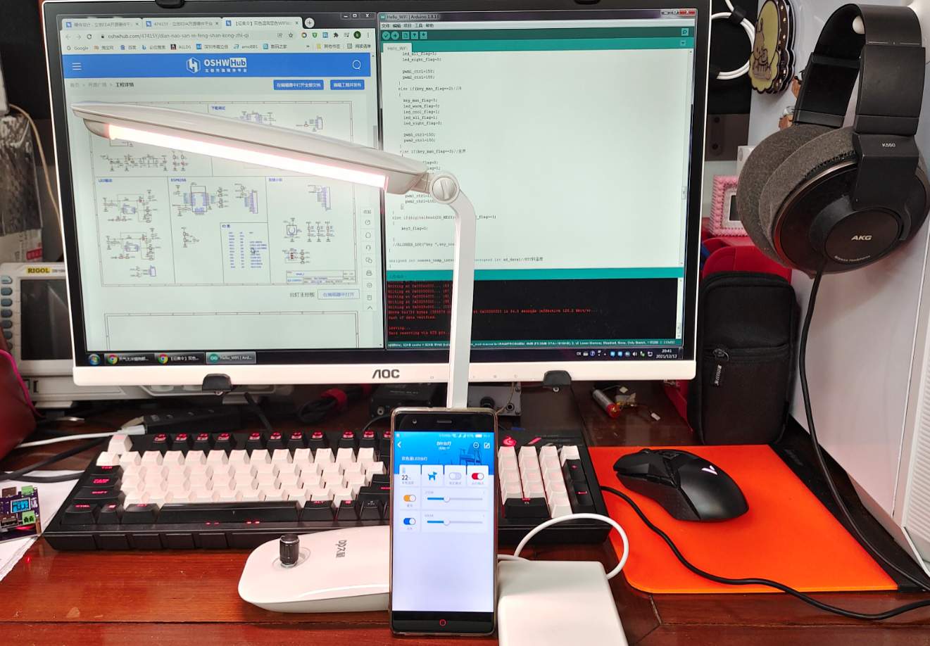

It’s the first time to use ESP8266, and it’s also the first time to use Arduino. If you are not familiar with it yet, use Dian Deng Technology’s APP first. DIY a simple and practical desk lamp.
Renovate a desk lamp you bought earlier and use its shell. Change to a WIFI desk lamp with high color rendering, dual color temperature and adjustable brightness.
Encoder and mobile APP dimming. 5V 1A or above power supply. The power is about 5W.
Two-way constant current DCDC dimming, non-PWM direct dimming, the light does not flicker.

The main control uses ESP8266 and Essence’s module ESP-12F.
Onboard is a ch340 serial port to USB, automatic download circuit.
The LED driver part uses two SGM3732 to boost constant current drive. Drive two LEDs with color temperatures of 6000K and 2700K respectively. LED is 6 series 4 parallel × 2.
One NTC is used to display the local temperature.
The motherboard and key board are connected using FPC 12P 0.5mm cable.
The key board has a rotary encoder and RBG light for manual dimming and status indication.

The software part uses Arduino IDE. See attachment for procedures.
The APP editing page of Dian Deng Technology.
