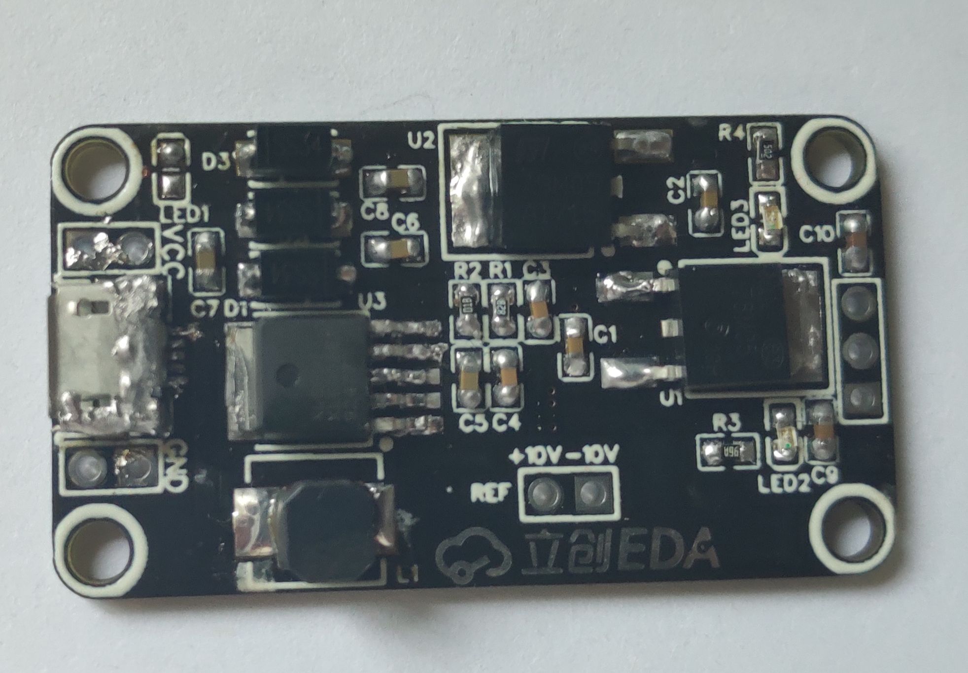

Low-cost ±5V power module based on XL6008
Update: Proofing and welding have been completed, and the functions are correct.
image.png                                                                  The conditions at home are limited, so the soldering was all mushy (especially the USB port), so I automatically ignored (dog-headed)               image.png              image.png precautions:
  • I forgot to add a current limiting resistor to the input voltage LED light, but it does not affect the function. The PCB diagram has been modified.
  • Important: The pin location and function of 79M05 in Lichuang EDA were wrong before, please check carefully
  • The LED current limiting resistor at the -5V output needs to be slightly larger, otherwise the LED may burn out the moment it is powered on.
  1. This project is improved based on the modules purchased in the laboratory.Snipaste_2020-04-01_11-58-55.png
  1. The PCB is 45mm long and 25mm wide. It can connect to 5V voltage through micro-USB, or input voltage through the reserved pin header. The theoretical input voltage range is 3.2V-36V, and the actual input voltage cannot be too large.
