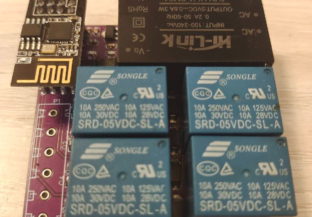

The four-way relay is controlled by esp01 to realize remote control of household fan 1, 2, 3 gears and shaking head.
AP mode forced authentication realizes connection blinker mqtt connection and permanently saves the key wifi ssid and password
The latest code: https://github.com/fuxudongdong/ESP8266
The DianDeng Technology interface configuration code is as follows:
{¨config¨{¨headerColor¨¨transparent¨¨headerStyle¨¨light¨¨background¨{¨img¨¨assets/img/headerbg.jpg¨¨isFull¨«}}¨dashboard¨|{¨type¨¨deb¨ ¨mode¨É¨ bg ¨É¨cols¨Ñ¨rows¨Í¨key¨¨debug¨´x´É´y´Ë¨speech¨|÷¨lstyle¨Ê}{ßA¨btn¨¨ico¨¨iconfont icon-shake¨ßCʨt0¨¨Shake your head¨¨t1¨¨Text 2¨ßDÉßEËßFËßG¨btn-hand¨´x´É´y´¤CßI|÷ßJÊ}{ßA¨ran¨ßN¨ stall¨¨clr¨ ¨#389BEE¨¨max¨Ì¨min¨ÉßDÉßEÏßFËßG¨ran-speed¨´x´Ë´y´¤CßI|÷ßJÍ}÷¨actions¨|÷¨triggers¨|÷}
