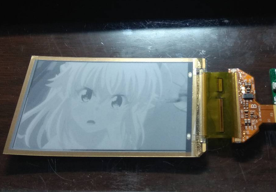

It was a project last year (week 52 of 2019). Today (week 18 of 2020) I was sorting out the debris and saw those dusty screens. I thought about it and decided to post this project. Whim?I bought a few screens.Then we need to light it up and consume the 401 inventory.Hence this project.

I made two versions. The first version was missing two tubes of unknown purpose (?), but it was still usable. Because of my obsessive-compulsive disorder, I made another version and added a 25Q norflash. TIM screenshot 20200426133655.bmpIMG_20200426_133238.jpgwx_camera_1577704343526.gif
Bright screen code engineering accessories self-pickup
