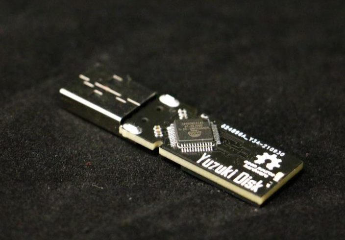

I tried drawing a U disk board and practiced on four-layer boards.

After the college entrance examination, I accidentally discovered the software LCEDA. I tried using some simple boards and found it very useful. It gave me, a useless person who had downloaded and deleted AD three times, a new light. On July 1st, Jialichuang was free to sample the 4-layer board. I knew it was time to fulfill my unfulfilled wish, so I drew the circuit in one night. After several modifications and several prototype tests, we finally have a usable main control board.
Project Description
A U disk main control board (PCBA) based on Alcor AU6989, with minimal design, minimal peripheral circuits, and support for VCCQ 3V3 flash memory.

Change log
  • V1.4
    • Refactor wiring, PCB layout
  • V1.3
    • Verification completed, card opened successfully
    • I was beaten because I was too bad at drawing on the board. I had to draw again. Woohoo.
    • Low quality USB A head, I really love you! ! ! image.pngimage.pngimage.pngimage.png
  • V1.2
    • Verification partially successful, but there is a problem
    • When I tested the power on, the computer had a blue screen: the USB data cable was connected reversely (grass
  • V1.1
    • Updated BGA152 pad to use simplified design
    • The main control adopts an oblique design, and the crystal oscillator circuit is temporarily removed.
  • V1.0
    • Complete drawing and proofing
    • Verification failed, there is a problem
