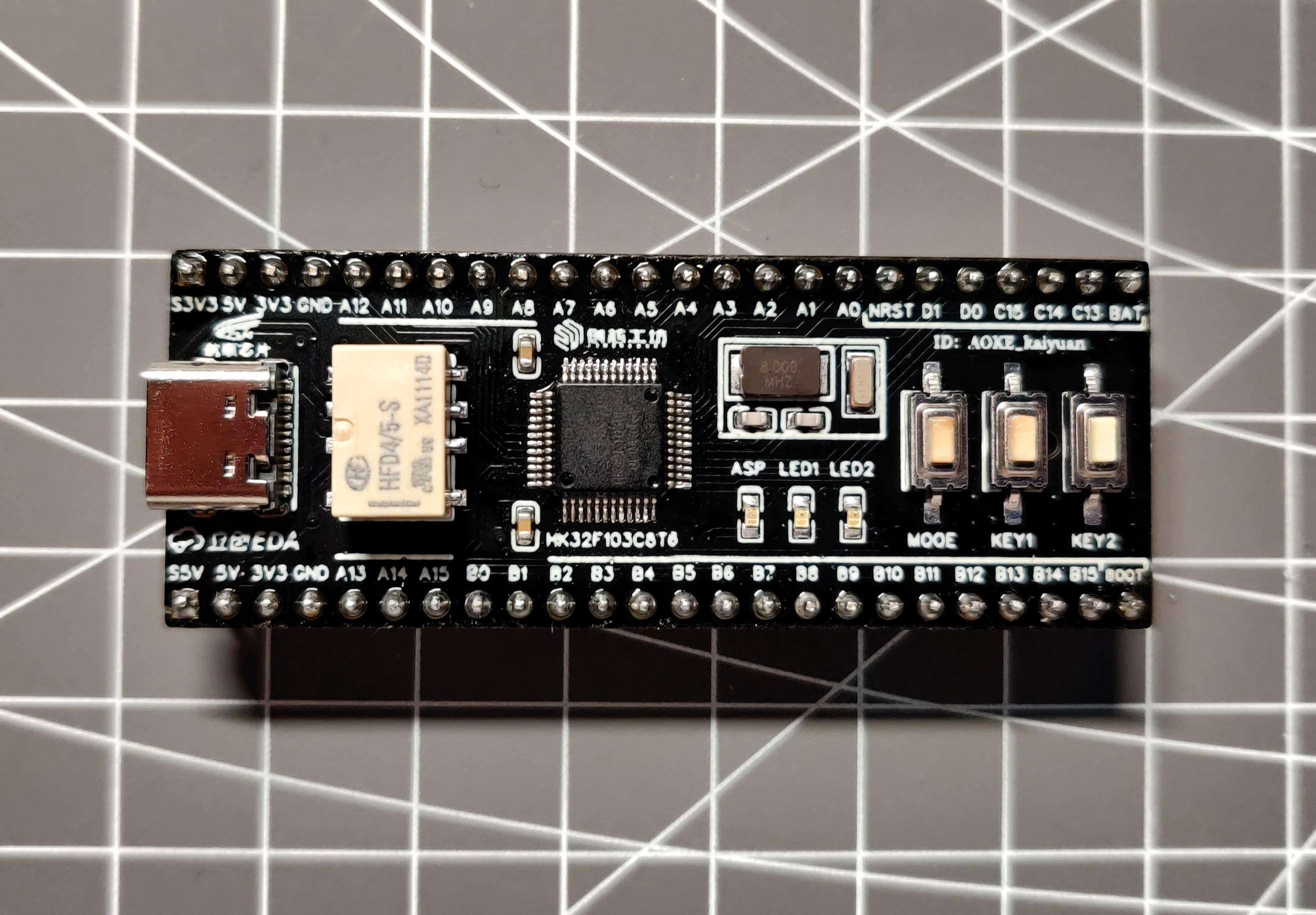

2021-03-21 21:38
Solder components for testing!
Different from what I expected
The BOOT0 and BOOT1 levels of C8T6 can be switched through STC15W201S
Only use the MOOE button to realize different program download and running modes
The test process cannot download the program normally through this method!
But pull BOOT0 and BOOT1 low and high through normal Dupont lines .
The program can be burned normally !
The ASP function of this core board is not implemented! So you can only manually jump the wires and burn the program!
But everything else is normal! The video shows a MIDI music routine!
This project ends! There will be no further updates!

Actual picture - front
Actual picture - back
