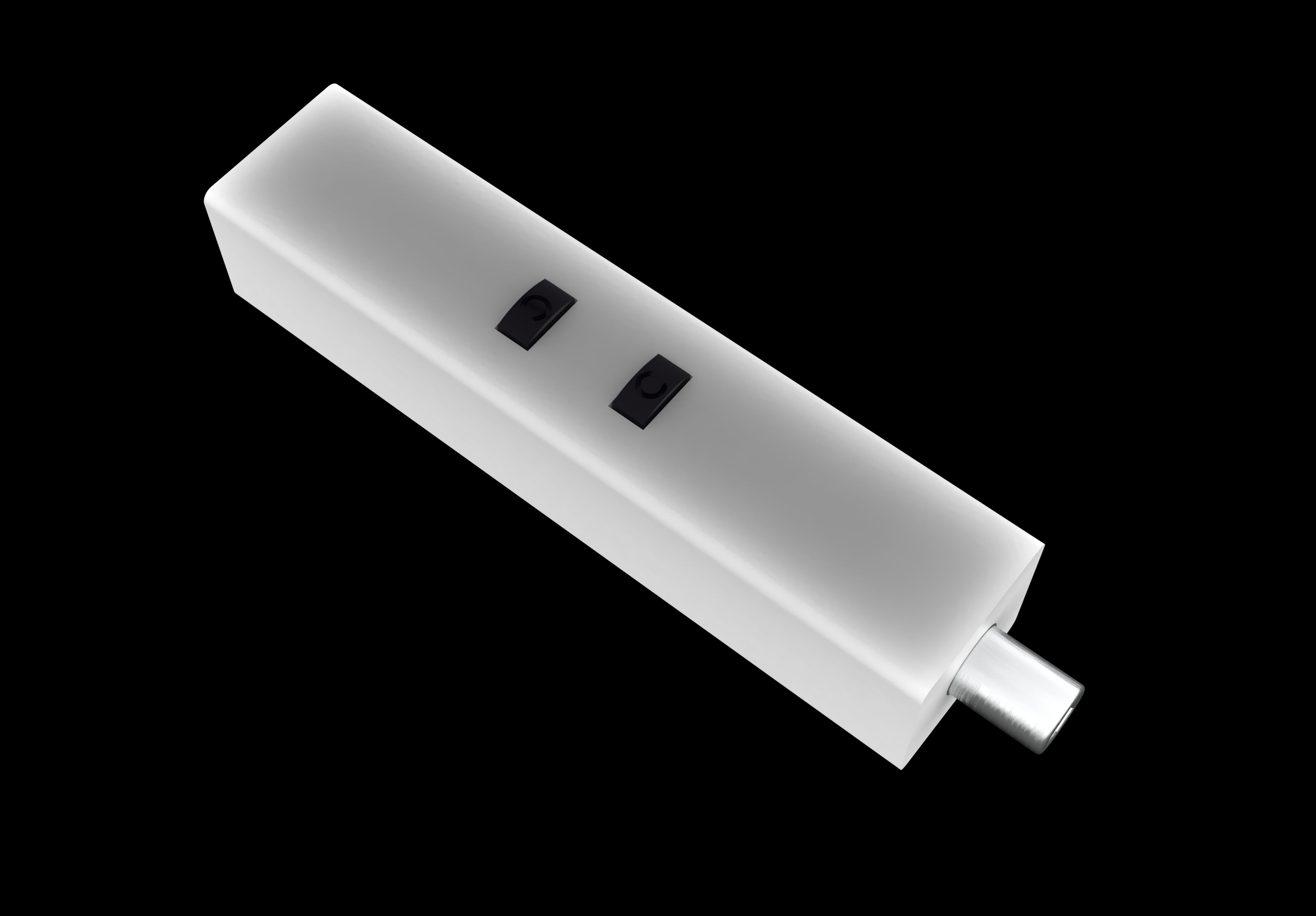

electric screw driver
The electric screwdriver I made during the summer vacation is open source here (for PCB engineering program files and 3D files, please visit https://gitee.com/yujinqu/electric-screwdriver-1-00). It uses the STC8F2K chip as the main control
It has a low-voltage alarm (VCC<3.0V) and low power consumption (current <75ua when the entire system is not working) using an N20 reduction motor with 12V 1MIN/100 rpm and a very large torque. The two buttons are forward and reverse respectively.
The low power consumption and voltage detection of program files are worth learning
