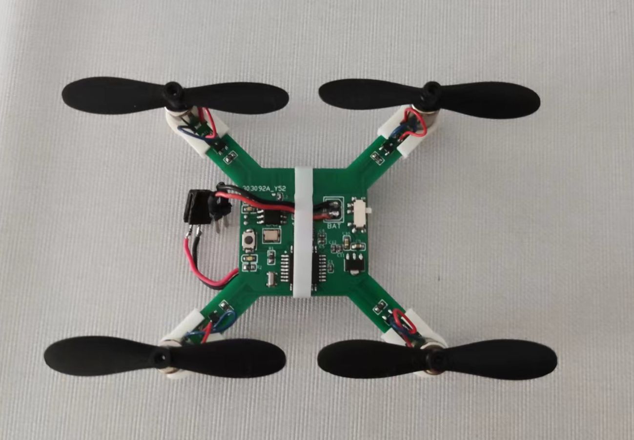

Project hardware introduction
Most components of the flight control are placed on the front of the board, including the main control Atmega328, the gyroscope MPU6050, the electronic compass HMC5883, and the serial port. Bluetooth chip KT6368A.
The barometer model BMP180 is placed on the bottom of the board in order to prevent the airflow from the propeller from affecting the barometer. There is also a PPM receiver interface reserved on the bottom. The open source supports remote control control. If you don’t want to use a small four-axis, you can use it as a large four-axis flight control. However, you need to modify the relevant parameters, recompile and download the flight control firmware.
Note: If you choose 1mm
    master control Atmega328 for proofing board thickness, you need to pre-burn the arduino bootloader. It will be easier to buy the 328 version of the arduino pro mini module and disassemble the chip.
The motor base of a 7mm diameter coreless motor is designed. The actual assembly effect is as follows.
