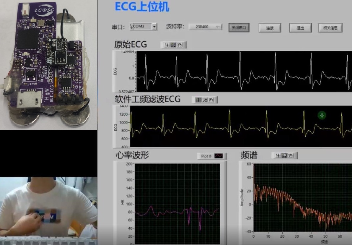

The hardware mainly consists of 3 parts: ECG, BLE, and power supply. The hardware block diagram is shown below:
4.1 ECG part
The original ECG signal (0.1~2mV) is amplified 1000 times through a precision instrument amplifier, and then the 50Hz noise interference is filtered out through a band-pass filter composed of a low-pass filter and a high-pass filter.
The instrumentation amplifier is AD8420 from Analog Devices. The AD8420 is a low-cost, wide-supply-voltage amplifier product whose gain can be set to any value between 1 and 1000 using two resistors. The device is optimized for amplifying small differential voltages in the presence of large common-mode signals and has excellent input common-mode range, based on a current-mode architecture. Unlike conventional instrumentation amplifiers, the AD8420 can easily amplify signals at or slightly below ground without requiring dual power supplies. The AD8420 has a full-range rail-to-rail output whose output voltage is completely independent of the input common-mode voltage. The typical application circuit is shown in the figure below:
The filter uses AD8657 from Analog Devices. The AD8657 is a dual-channel micropower, precision rail-to-rail input/output amplifier optimized for low power and wide operating supply voltage range applications. Typical quiescent supply current is 18 μA. This type of device uses Analog Devices' patented DigiTrim® adjustment technology, which has very low offset voltage and high immunity to electromagnetic interference. Another channel of the AD8657 feeds the output of the ECG and the right leg drive input to the reference of the instrumentation amplifier, further suppressing noise interference. The typical application circuit is shown in the figure below:
Since the ECG part has positive and negative voltages, and the ADC of the BLE part can only convert positive voltages in the range of 0~3V, AD8531 is used to form an adder to convert the ECG signal to +1V. This facilitates the ADC to sample the ECG voltage. The AD8531 pin diagram is shown below:

First make sure that the power supply part is working properly. When the power is not on, measure whether the positive and negative poles of the 5V input are short-circuited, whether the positive and negative poles of the lithium battery interface are short-circuited, whether the positive and negative poles of the 3V power supply are short-circuited, and whether the positive and negative poles of the -3V power supply are short-circuited.
When the lithium battery is not welded, connect the 5V charging voltage and measure the voltage of the lithium battery interface to be about 4.2V. The voltage stabilizing chip outputs +3V voltage, and the voltage inverter outputs -3V voltage. Make sure there is no problem with the power supply, then test the ECG part.
Input a 2mV, 20Hz, 0V offset sine signal through the signal generator, as shown in the figure below:
Probe the waveform at the output of the amplifier with an oscilloscope. If there is no problem with the circuit, the peak-to-peak value of the output waveform voltage is about 1.6V, the frequency is 20Hz, and the offset voltage is 0V. Test the output end of the ECG again. The output waveform is consistent with the output waveform of the amplifier. After passing through the adder, the waveform is offset by +1V. The two output waveforms are shown in the figure below:
Then set the frequency to 50Hz, the frequency of the amplifier output waveform also becomes 50Hz, and other parameters remain unchanged. As shown below:
      Test the amplifier output and the ECG output again. It can be seen from the waveform of the oscilloscope that the output of the amplifier is amplified 1000 times to 2.11V. After passing through the filter, the voltage amplitude attenuates to 330mV, achieving the suppression effect on 50Hz power frequency interference. The waveform diagram is shown below:
After testing with the signal generator, there is basically no problem with the circuit. Then see the waveform by actually measuring the ECG. Place the dry ECG electrode on your chest, as shown in the picture below:
You can see the ECG waveform and the ECG waveform offset by the adder. The waveform is good, as shown in the figure below:
In ECG detection, the impact of power frequency interference is relatively large. We zoom in on the waveform and take a look at the 50Hz power frequency interference. It can be seen that there is almost no 50Hz power frequency interference, and the filtering effect is quite good. As shown below:

The host computer is used to receive ECG, battery power and other data, and process and display them. The overall software block diagram is shown below:
The host computer is developed based on the visual programming software Labview of NI Engineering. The software is easy to use and can directly call the controls. It greatly shortens the development cycle and is very suitable for DEMO verification and development. LabVIEW (Laboratory Virtual instrument Engineering Workbench) is a graphical programming language development environment. It is widely accepted by industry, academia and research laboratories as a standard data acquisition and instrument control software. LabVIEW integrates all functions for communicating with hardware and data acquisition cards that meet GPIB, VXI, RS-232 and RS-485 protocols. It also has built-in library functions that facilitate the application of TCP/IP, ActiveX and other software standards. This is a powerful and flexible software. You can use it to easily create your own virtual instruments, and its graphical interface makes the programming and use process lively and interesting. The LabVIEW development environment integrates all the tools engineers and scientists need to quickly build various applications, and is designed to help engineers and scientists solve problems, increase productivity, and continuously innovate.
The final host computer display interface is shown in the figure below:
