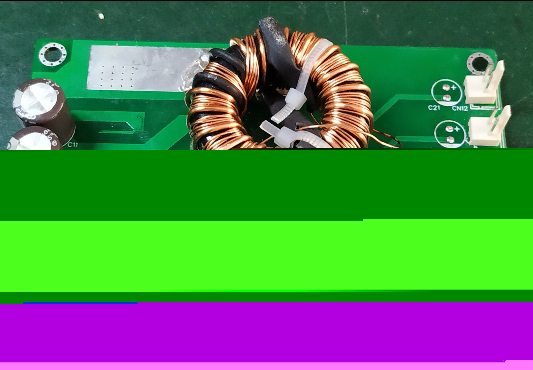

PCB blank board:
PCB front:
Regarding the winding of the magnetic ring, use a 270125 magnetic ring. The number of turns on the primary side and the 5 sets of secondary sides are the same (more than 10 turns and less than 18 turns), except that the primary side needs a thicker wire diameter.
PCB back side:
In the red circles 1 and 2 in the picture below, except for the resistors that need to be soldered, the remaining capacitors should not be soldered:
The green oil board in the video and the white oil board circuit are the same.
