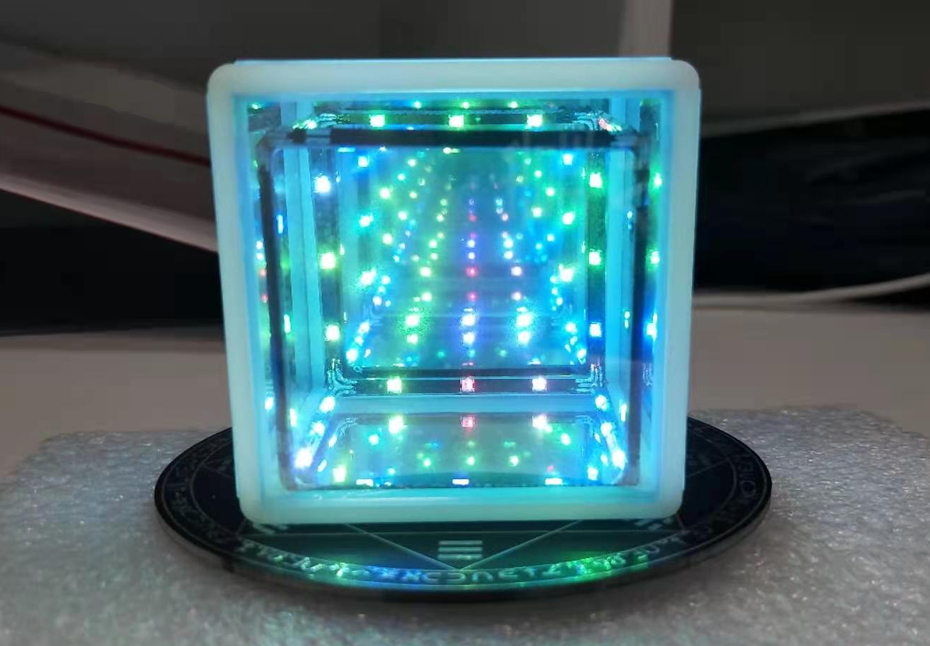

This is optimized based on the time-space cube I made before . The demonstration video is at station B. You can click on the link to watch it.
It is said to be optimization, but in fact, the software and hardware architecture of the desktop decorative lamp designed this time has been completely changed.
hardware design
The current design is divided into two parts
the top half
It is a cube skeleton 3D printed using Jialichuang's 3D Monkey . The six sides are empty. Then 12 LED light strips are used to weld it into a cube, which is placed in the 3D shell and laser engraving machine is used to follow the specified size. Cut the transparent acrylic and paste it with a semi-permeable film, seal the 6 sides, and then turn on the power to achieve the effect of an infinity mirror. There are many colorful LEDs flashing inside to achieve the effect of bright stars.
the second half
Use PCB to draw a circular base, draw some appropriate patterns on it, and supply power to the upper half of the cube through the pads on it;
In fact, although the texture of this bottom plate seems to be drawn randomly, there are also some small thoughts. For example, this Bagua picture is not randomly placed, but intentionally inverted: the Bagua corresponding to the touch button is Gan, which is Wang. Corresponding to the full moon of the Mid-Autumn Festival, it means perfection.
Furthermore, the size of the Bagua is based on the size of the actual 3D printed cubic lamp, which plays a role in determining the position.
Another function of the base is to realize a Bluetooth keyboard with touch buttons by equipped with Qinheng CH573 .

The last time I tested the welding of the light panel, it was quite easy, but this time it was very difficult to weld the new light panel. The welding bracket was almost burnt before I could weld it so well. Maybe it has something to do with the color of the board this time. 06.jpg07.jpg08.jpg Fortunately, the welding is finally completed.
0907
Today I combined the two parts into one, and the effect is quite good. 09.jpg10.jpg11.jpg13.jpg14.jpg The video is attached.

Recently, many friends have made this cubic lamp, and encountered some minor problems. Let me describe them briefly:
1. The on-board antenna does not need to be welded, the antenna is on the top layer;
2. The chip uses Qinheng CH573F, QFN package. When welding, I used solder paste + hot air gun for welding. So far, the success rate is relatively high.
3. To power the cubic lamp, I purchased a finished DC-DC power module (Yibat DC-DC step-down power module | 12V to 5V | 3.3V 24V to 5V/3.3V, 5W voltage stabilizing module), the voltage is 3.3V , please search by yourself. As for why I chose this module, it was because I didn’t want to use an LDO because the larger current would cause too much heat. But at the same time, I didn’t want too many peripheral components and I wasn’t good at circuits, so I chose a finished module.
4. The following LED-ZFM is recommended for the light panel. Relatively speaking, cutting will be a little easier.
5. The recommended solder resist color for the lamp board is black; the thickness is 0.8mm; the recommended solder resist color for the base plate is black, and the thickness is 1.6mm.
6. Acrylic cutting size: 48x48x2mm.
7. Reflective film is a common window shading film on the market and is very cheap.
8. If you are not confident in your welding skills, it is recommended to 3D print the welding auxiliary bracket together, which can slightly reduce the pressure of welding the cubic light.
9. Use wchisp to download the program.
10. The lamp beads of the cubic lamp change color by themselves. There is no separate program control, and they do not accept signal control. If they run for a long time, the color inconsistency between different lamp beads will be caused by the time difference.
11. The cubic lamp and the lamp panel are directly connected to each other through a probe-like structure for power supply.
Above, that’s all I can think of for now. Welcome to leave a message with questions, answers and suggestions!
