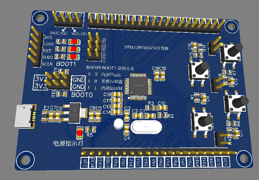

Made a STM32F030C6T6 minimum system board~Why? Because STM32F103 is too expensive now~ It happened to be Double Eleven, so I bought some STM32F030C6T6 on Taobao for a few yuan. I don’t know if it will work. So I made a development board to verify the function myself and realize the function of the microcontroller. Currently The board is still being prototyped. All functions will be verified later and will be updated continuously. Everyone is welcome to give us advice.
Principle: STM32 is currently a popular microcontroller learning class, but due to factors such as the high price of STM32F1, I made an STM32F030C6T6 microcontroller board to test my results in learning STM32 again! Among them are only MicroUSB, step-down chip AMS1117-3.3V, download circuit, communication circuit, reset circuit, running light circuit, button circuit and expansion pin header. The most important thing is that I led out all the pins, and even if It is to realize the button function or running water lamp function. It cannot be realized without plugging in the corresponding jump cap. In this way, we can change the function of using this pin. We don’t have to use it as a running water lamp or button. We can Connect other modules through Dupont cables to achieve more functions~
Function: STM32F030C6T6 minimum system board~~~Verify the results of learning STM32, and later make a video to explain its use~
