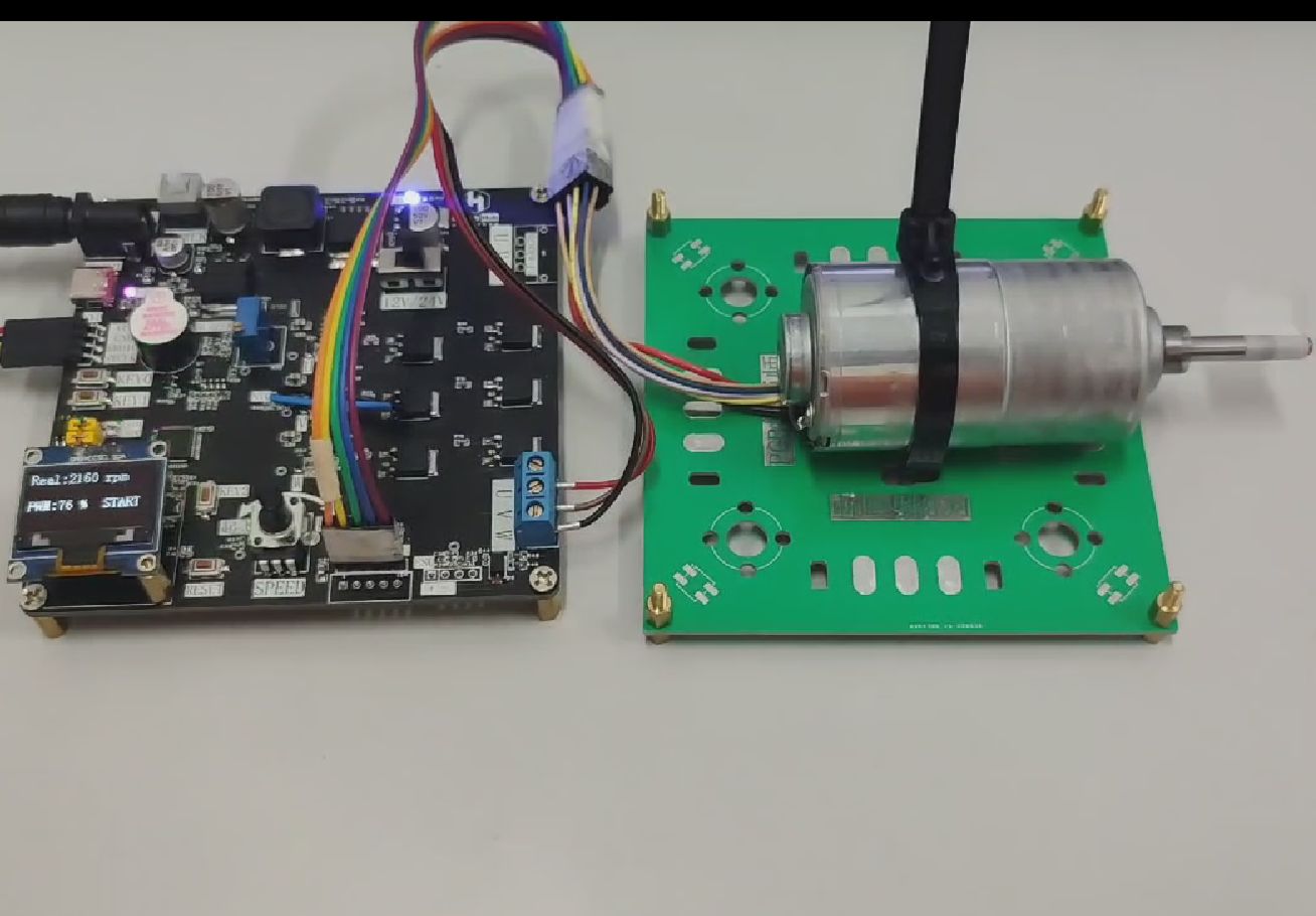

Control driver board for brushless motor based on CW32 (sensory or non-sensory), 10*10cm;
Brushless motor fixing plate, drawn according to the selected motor, aluminum base plate. 10*10cm;
12V power supply, which can be boosted to 24V or higher (see XL6019 data sheet for details);
Toggle switch controls MOS main power supply;
Onboard USB-TTL, TYPE-C interface, equipped with a resettable fuse, CH340N, connected to the MCU through a jumper cap;
Reserved 4-pin SWD debugging interface;
Reserved 0.96-inch IIC protocol OLED screen interface, IIC signal line has been pulled up, plug and play;
Two output ports, MR30PW-FB/screw terminal block, are reserved;
The procedure refers to the official training camp routine;
