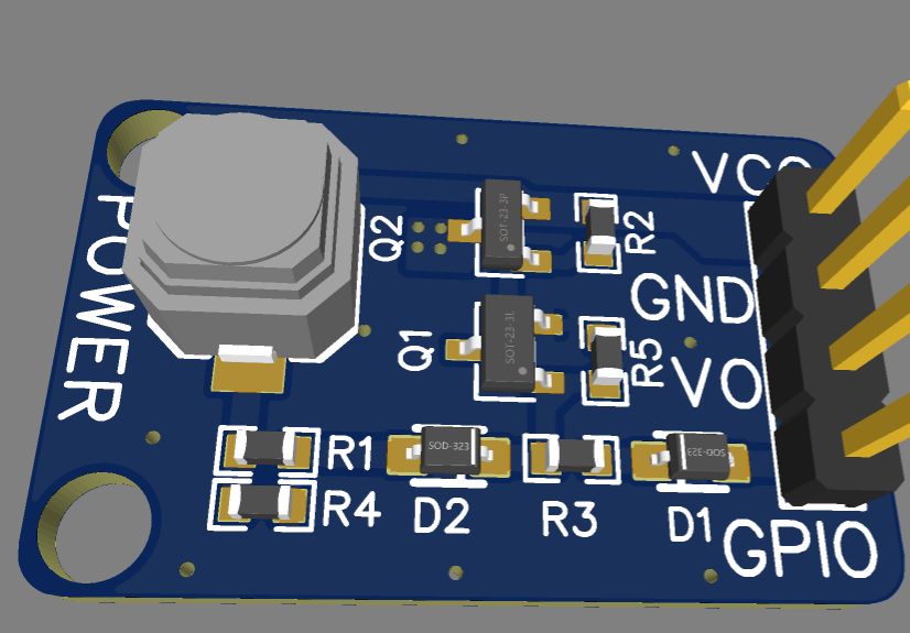

In this article, we will show you how to build a latching power switching circuit , also known as an automatic power-off circuit . You can use this circuit to automatically shut down an ESP32, ESP8266, Arduino or any other microcontroller.
This circuit allows you to completely cut off power when the microcontroller is not performing any tasks. In other words, once the microcontroller has finished executing its task, it shuts itself down via software. This is a great way to make batteries last longer in your electronics projects.
Automatic shutdown circuit diagram
The following circuit diagram shows the latching power switch circuit (auto power off circuit) diagram.
Power latch circuit schematic diagram esp32 esp8266 arduino
The terminals numbered 1, 2 and 3 on the right side should be connected to your microcontroller board.
  • Pin 1  is connected to 5V.
  • Pin 2 can be connected to any digital pin of the microcontroller. In our example we connect this pin to GPIO 5 / Digital 5.
  • Pin 3  is connected to GND.
  • How the automatic shutdown circuit works
    1) When you press the switch or close the circuit, power reaches the base of the 2N3904 transistor. Therefore, the 2N3904 is pulled low, pulling the gate (G) of the MOSFET to GND.
    2)  A P-channel MOSFET turns on when its gate is negative relative to its source. When you press the button, the gate of the MOSFET is pulled to GND, allowing current to flow to the VIN pin, which will power the microcontroller. This occurs whenever the gate of the MOSFET is pulled to GND. 3) To keep the gate of the MOSFET pulled to GND after releasing the button, we send a HIGH signal through the GPIO of the microcontroller. When we send a HIGH signal, power reaches the base of the transistor. 4)  Therefore, we ensure that the gate of the MOSFET is pulled to GND and the current flows to the VIN terminal to power our microcontroller. 5) When we want to turn off the circuit, we just set the GPIO to LOW. When this happens, no power reaches the base of the transistor, so the MOSFET does not allow current to flow to the VIN pin and therefore no power is dissipated. The minor changes I made to the circuit,8CNk4GCI6PQ9lGTtautJrKQeNTcKJwu8VeYnxHTT.png
  • PCB
  • Test code based on MounRiver Studio
  • PA1 controls the GPIO pin
  • PA0 controls the LED to indicate the operating status of the microcontroller.
