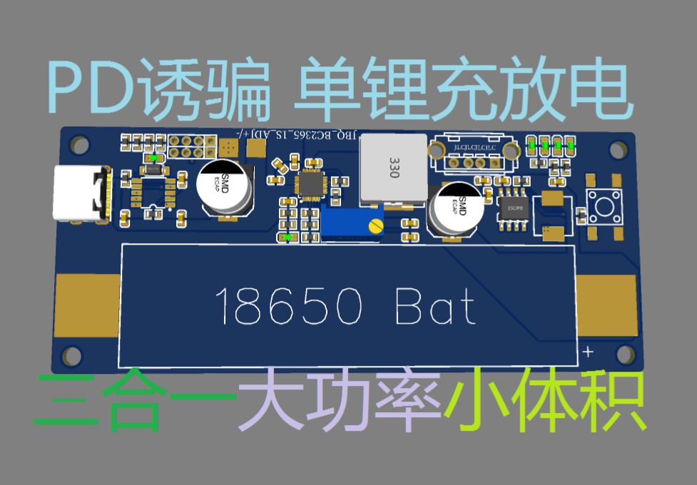

PD, QC and other fast charging protocols deceive 18650 charger emergency mobile power supply
对于18650充放电管理模块:
Chip main control: IP2365 Input voltage: 5-26V Output voltage: 4.2V Output current: Adjustable with potentiometer to a maximum of 3A Charging status indication: Flash slowly at a frequency of 0.5HZ during charging, constant when fully charged
对于PD诱骗模块:
Chip master: FS312 Input voltage: within 21V Output voltage: can be output to PD20V through deception. Maximum output current: depends on the output mode of the decoy end. Weld the onboard pad and connect the load. The module does not reserve the deception output USB welding position.
对于紧急移动电源模块:
Chip master: IP530X (all 530 series can be used) It is an emergency mobile power module based on the IP530X series. It depends on the model of X welded. The default is 5306. The battery output current can reach more than 2A. 4 percentage power display LEDs are activated by the button.
1: [Midnight on August 8, 2020] The open source PCB project has been delivered to Jialichuang, and the actual test is under planning
2: [2020-8-12 noon] The board was received and some components and the complete circuit were welded
