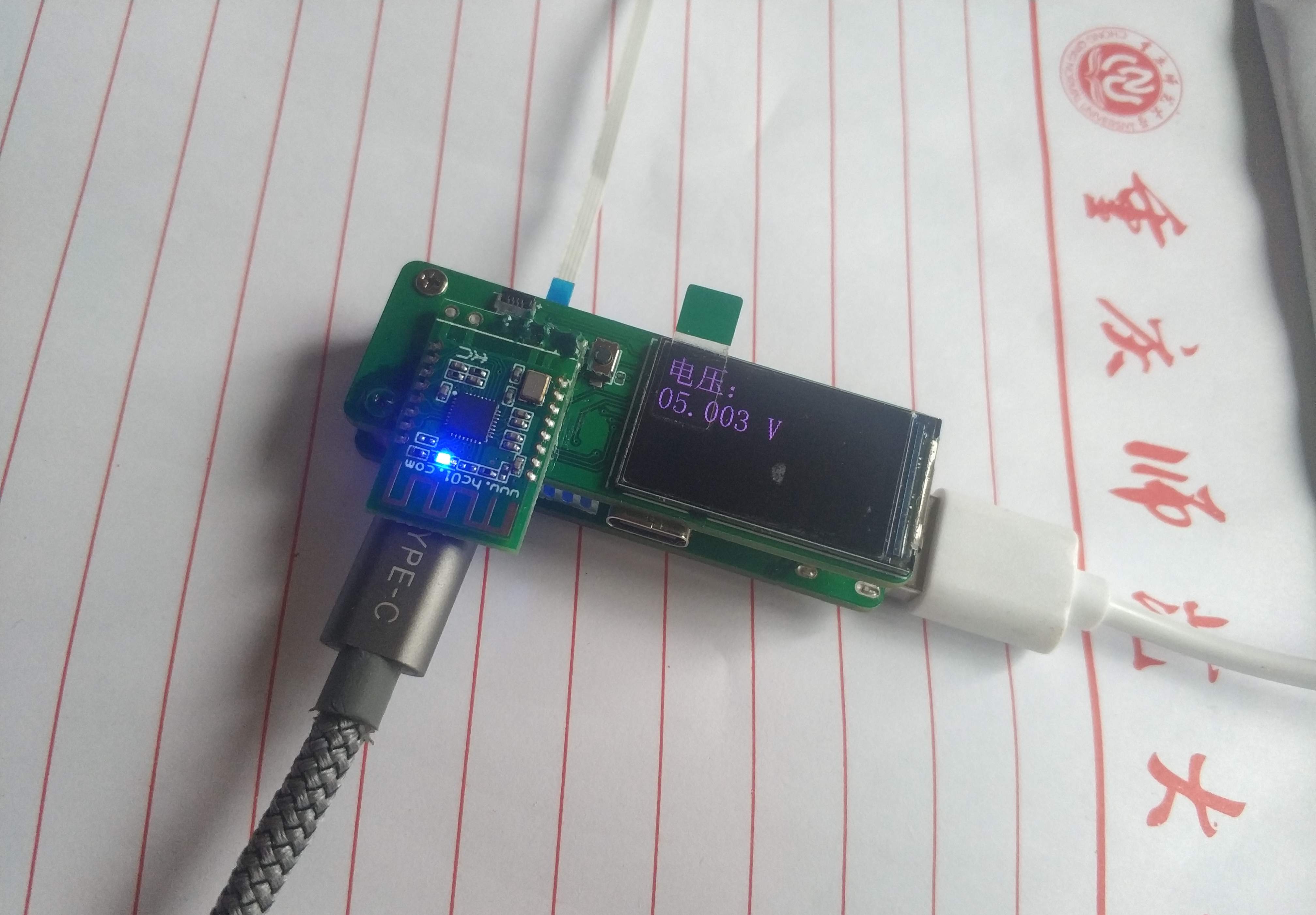

* 1. Introduction to project functions
The USB adjustable power supply (Bluetooth adjustment)
MqY7MdJiqYqKOBLLfajDVUgLQCiWEChYpg12KfhD.pngshell has been drawn, but it has not been made yet and needs to be modified. The shell in the project cannot be used temporarily.
Current detection cannot be used in the old version (V0.0), and the new version (V0.1) has not been verified yet, but the adjustable power supply function is still available
with PD, QC fast charging request.
The maximum request voltage is 15V, and the default request voltage is 12V (my own charger can only reach a maximum of 12V1.5A, and the 15V request cannot be measured)
·VINMAX: 15V
·VOUTMIN: 1V
·VOUTMAX: VIN-2V
Output ripple:
·1V~10V no-load: The oscilloscope is too weak, it can't be measured, a straight line
·1V0.25A: It can't be measured, a straight line
·4.0V1A: 30mV
6rdeUFaybOrz8YkTX71pcdcpaafYBE9T4vAaRKdW.png·8.5V2A: 50mV
Avjb1eK4RujKajEFDmKU8o7MEjocvuTAlQjRqqkZ.png·3V3A: 30mV
1oYQE1Q3c6ouFhcN5czMxHmesEaydUAmzNhdox2n.png5V3A: 35mV
0gYpfbypmNFQNTgXx0Rzm8AIhCx0UbahLKi2glpK.pngload is a nickel-chromium heating wire
4uXrRNfztKdK5DRWTNK1vNl0pycU7Ra5oJwyL5DA.pngtemperature: The temperature on the board was not measured, and the heat was a bit high. The main heat source was the diode. The inductor and the driver chip can be touched at 3A current, but the diode is hot to the touch after one or two seconds (without a shell)
. The new version will improve the heat dissipation.
The old version (V0.0 version) is the first board, and it was also V0.0 version during the test. There is a problem with the current detection of V0.0 version.
The specific problem is: the input voltage does not meet the common-mode input voltage of the adc chip under the condition of 64,128 times gain.
Solution: Add pre-amplification, do not use the 64,128 times gain mode of the adc chip, and only use the 1,2 times gain mode. The common mode input voltage is AGND-0.1V~AVDD+0.1V at 1,2 times gain.
The new version has been drawn, but it has not been tested and verified yet.

is stacked, divided into upper board (power board) and lower board (control board)
Lower board (control board):
The +3.3V that powers the MCU (N32G430) is input by the fast charge request, given to the first-level DCDC, and the output is about +4.9V, and then stabilized to +3.3V by LDO.
In the request voltage control line, CFG3 is pulled up by hardware and cannot be changed, so only 5V, 12V and 15V can be requested.

m4InEHKTa9pvuWTI77Nsa1OZDWB7n5KboZAzD3df.pngoKHHIBfusHxPc9n01eOHyUmqfusEK4XFPX1vpa4q.pngBluetooth:
The serial Bluetooth module HC-04 from Huicheng is used. The hardware is directly connected to the UART3 of the MCU through a 4PIN fpc socket.
tE8SduwWFW58MqFKT15I2cIqawwUFWHAhHPQDGBs.pngDebugging and reset:
4DzmL6Nwa5bz4XAoNO4Ogyf7tfhYiPD29pZ8H91O.pngBoth the debugging interface and the Bluetooth interface are 4PIN 0.5mm fpc connectors, which need to be connected to debuggers such as stlink through an fpc adapter board. The same is true for Bluetooth
. This project does not include a Bluetooth board, so the Bluetooth tested is directly soldered on the fpc and then glued as a whole. The flying wire solder joints are painted with green oil.
