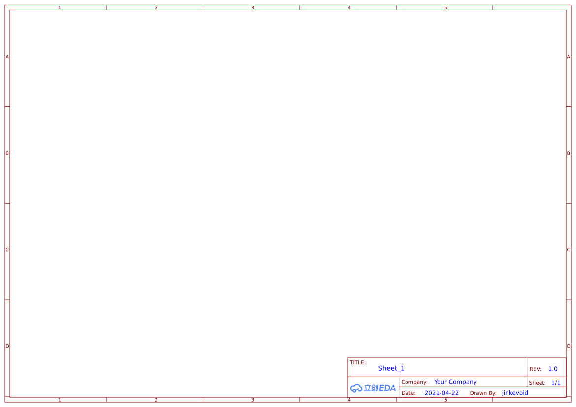

Use it in conjunction with another [eg8010 master control] I drew!
Basically, it is drawn with reference to the [EGS001 sine wave inverter driver board] and [EGP1000W inverter power board] from the official Yijing open source of the eg8010 chip, and the mos driver on the driver board is moved to the power board.
The official [EGP1000W inverter power board] supports 1000w power output. I haven't measured the highest power, but it can definitely be powered by 100w. Remember to make the heat sink larger.
The mos driver chip uses IR2110s, and the mos tube uses IRFp150, packaged in TO-247, or you can choose what you have on hand.
For the specific configuration, please see the official open source document in the attachment below. The introduction is very detailed and much better than what I said233.
